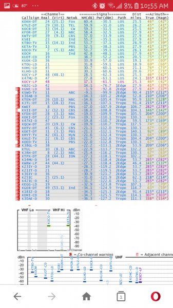

I recently cut the cord on my satellite and I am wondering which antenna would work best for me. Here is what tv fool gives me. Also is it possible to pickup some of the gray channels ? If not no biggie. Any help would be appreciated.

It shouldn't require a whole lot of antenna to pick up all of the channels marked with LOS. Going forward you'll have two VHF-high channels (RF7 and RF9) so you probably don't want to cut yourself off at the knees by using a UHF-only antenna. I'd guess that as long as you don't have designs on burying your antenna in an attic or basement, pretty much any 30-50 mile antenna would do for a household. For a single TV, an indoor antenna (that supports RF7) may work fine.
Something along the lines of the Channel Master CM-3010HD (~$20) is what I'd be looking at.
If you can't live without KBZC, you'll need to go through some hoops otherwise all the other towers are within 5 degrees of each other.

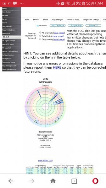

This is the other one it appears if i use cs vs county street i get different results
so which one should i beileve? Also antenna will be on outside how high should i go?

You REALLY NEED TO DETERMINE WHICH IS CORRECT FOR YOUR ADDRESS, LOS and 2 edge are 2 really different results, different antennas will be needed for 2 edge. Line of Sight could basically get away with rabbit ears.

Ok I put coordinates in instead of address a majority are LOS. I have an indoor antenna but struggle on pulling in the high vhf stations.
Getting an outdoor antenna with some VHF chops should fix that. Outside of rabbit ears, most indoor antennas are relatively lacking in VHF. Yours is particularly lacking if it can't pull in KETA.
The 1 edge stations may require a little more oomph and make a directional antenna even more important. Anything you can do to elevate the antenna will probably help. There's a reason some consider Oklahoma to be relatively flat (it appears to slope fairly gently from the pan handle down to the SE corner).
You'll have to put a value on KTOU, KUOK and KLHO as they're out of line from the other stations with pretty wimpy transmitters.
