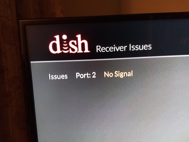

I did diagnostics and there was one issue found: Port 2 No Signal.

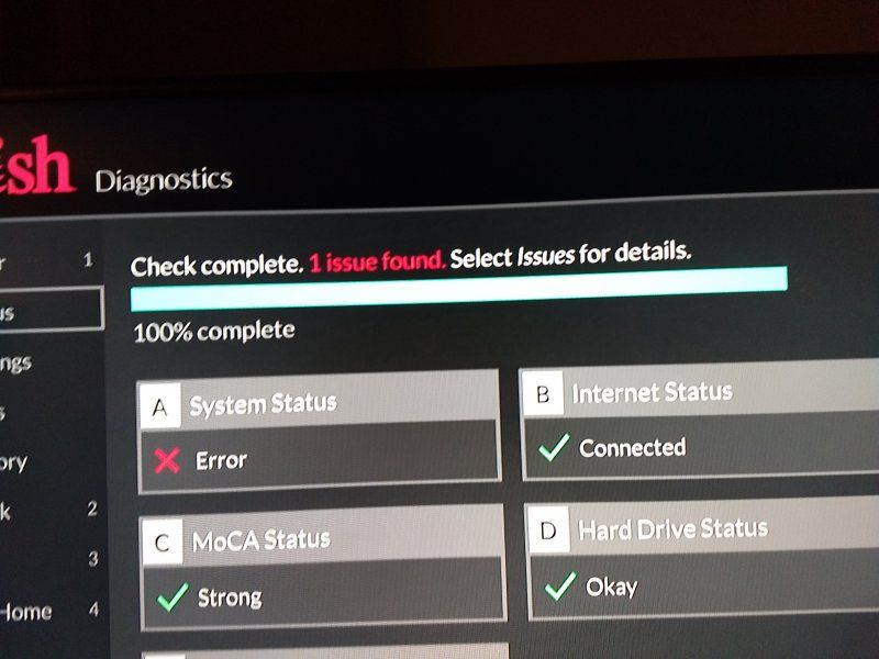

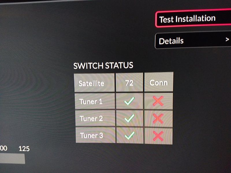

Thanks for the reply. I am attaching screen grabs from the Diagnostic test. I have Hopper 2 with Sling. Hybrid System. One coaxial from LNB to Coaxial splitter, one terminating to host and one terminating to Joey. One Hopper One Joey.
Test Installation results attached as well.

I can tell you seeing as how we're both in Maryland that "storms in peru" are not affecting you to me it sound like your duo node or hybrid hub depending on your install is either failing or that coax to port 2 on it is failing. You're only seeing the channels on the 72

Port 2 of the Node? He doesn't have one. He said he has a Hybrid LNB and no switch, there is no port 2. I think Port 2 must be a reference to one of the LNB positions.

Your LNB was either damaged in the storm or your dish is out of alignment. You're no longer receiving all of the satellite signals you need to receive. You can try to point your dish yourself or contact Dish and get a tech out.
