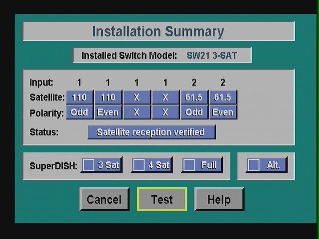

Dish6000 + SW21
Pizza1= Twin500 (110+119)
Pizza2= Dish300 (61.5)
There was no visible damage, Pizza1 just got moved out of alignment.
I had to get on the roof and re-secure the mount to the eve, verified the vertical post is perfectly plum, put the 500 dish back on, and lined up to my old marks. Since 61.5 Dish was not hit, I temporarily removed the SW21 + 61.5. Now that the 500 was going straight to the 6000, I started searching for 110/119.
I got 80% signal & Locked - E* 119. So I stopped & did a switch test and it found the Twin 500, but only the 119 Sat. And when I looked at Signal Strength for Sat 110 it would say 80% Wrong Sat - E* 119.
Went back up top and moved dish to the left, past a zero signal area, then back into a 80% signal. Did a switch test and it found Twin500, but only 110 Sat. And when I looked at Signal Strength for Sat 119 it would say 80% Wrong Sat - E* 110.
See the problem? It sees the Twin500, but only wants to see one Sat. Attached is a screenshot of the final switch test (with 61.5).
