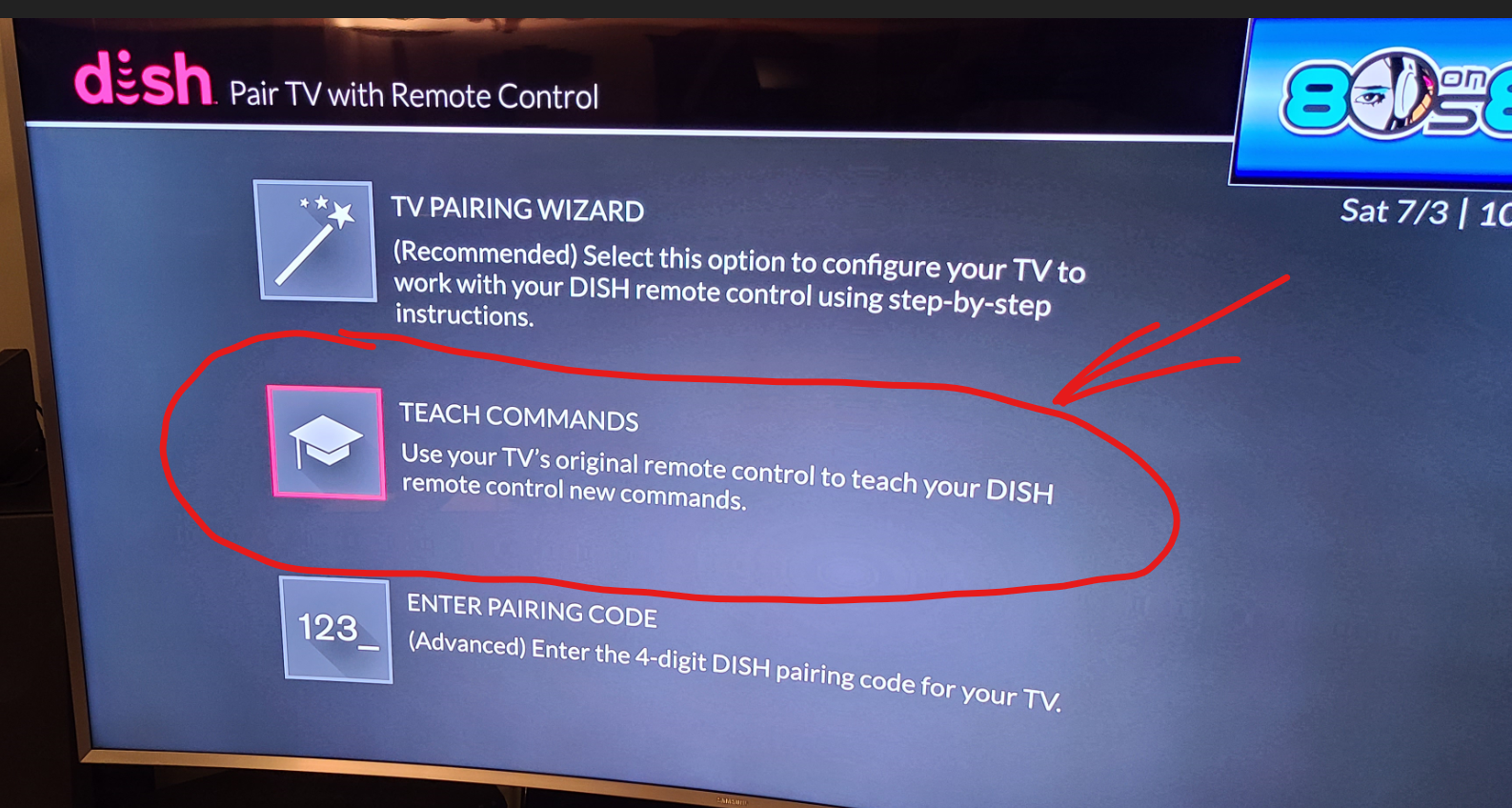

I take it you've tried to hit the Select button on the Dish and that it just doesn't work, right? You might be able to go into the learning mode and use the Select button (or whatever it may be called) on your TV's remote and assign it to a button on the Dish remote.

What I suggested above still might work if you want to give it a shot, despite the bs that their "support" was feeding you. In fact, I took a quick screen shot for you below. The description of the function specifically states it was designed to teach such missing commands to the Dish remote. I know I've used this to teach Dish remotes nearly every single function from a TV remote where the pre-configured codes weren't working for me. Once you go into the "Teach Commands", it will walk you through how to do it using the TV and Dish remotes together.
