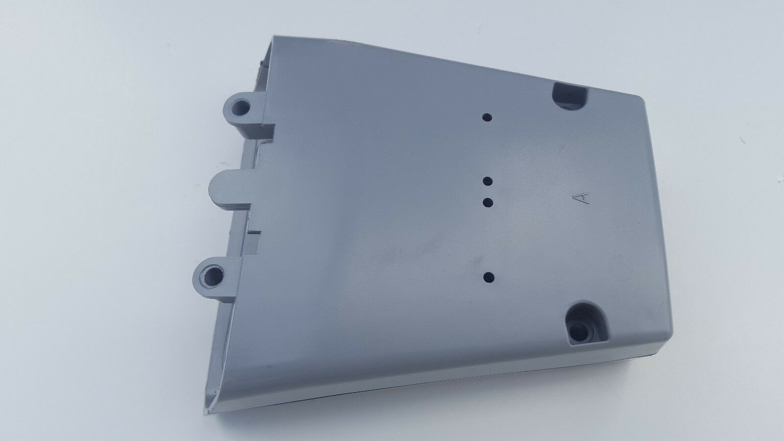

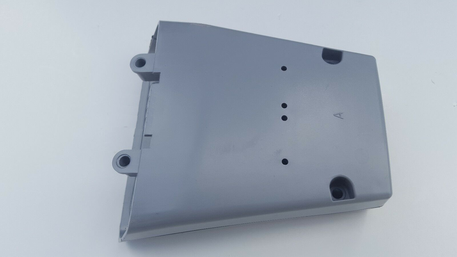

Before:
After:
The mod to use a 1000.2 LNB on a 1000.4 dish is a simple 2 minute fix using a utility knife. Just cut the center plastic tab off the adapter.

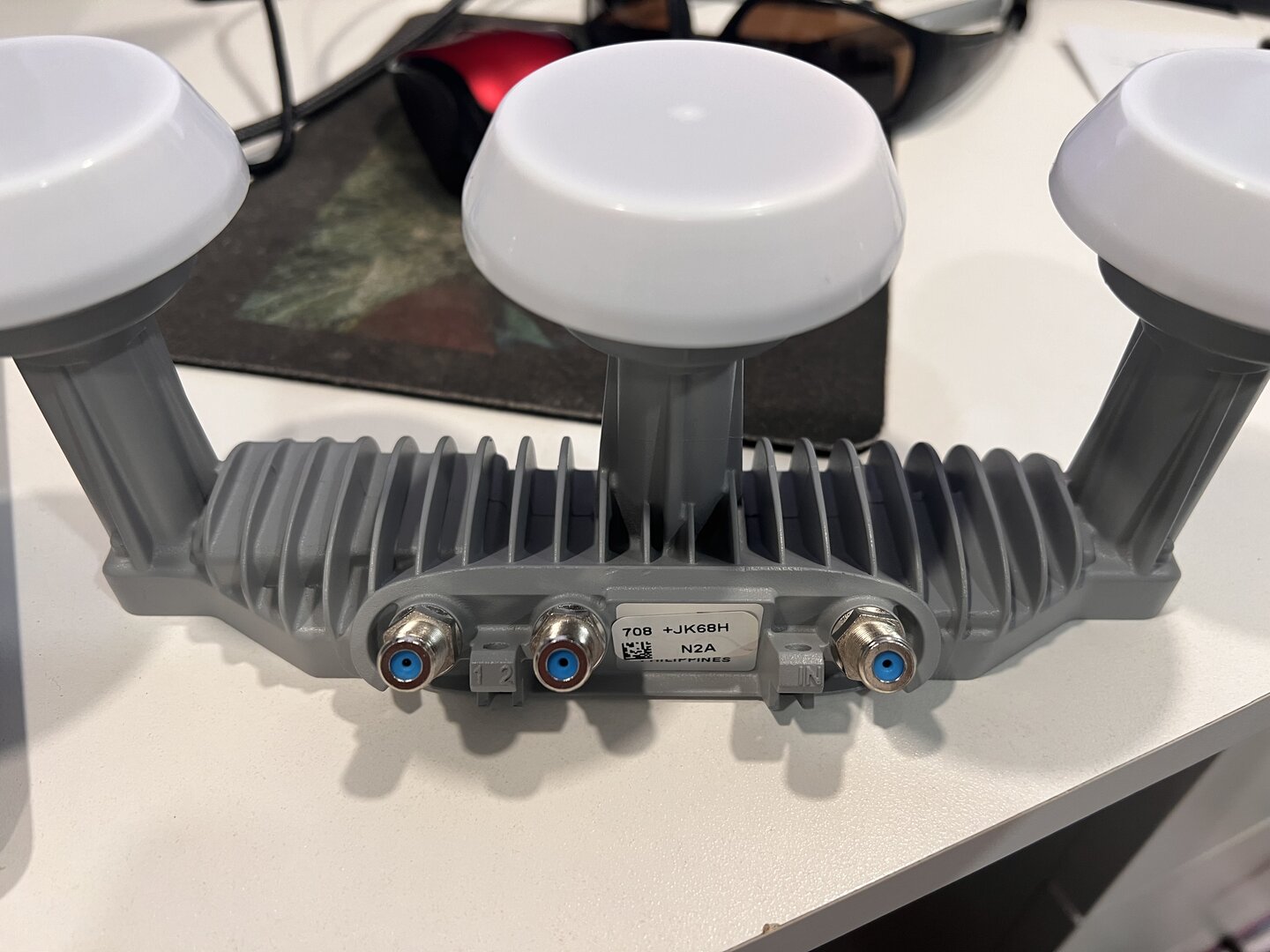

The western arc LNB pictured is the newer Dish "Slimline" hybrid version used on the 1000.2 dish.
