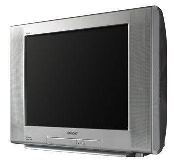

I think he is talking something similar to 32" FD Trinitron® WEGA® TV - FD Trinitron® Picture Tube
