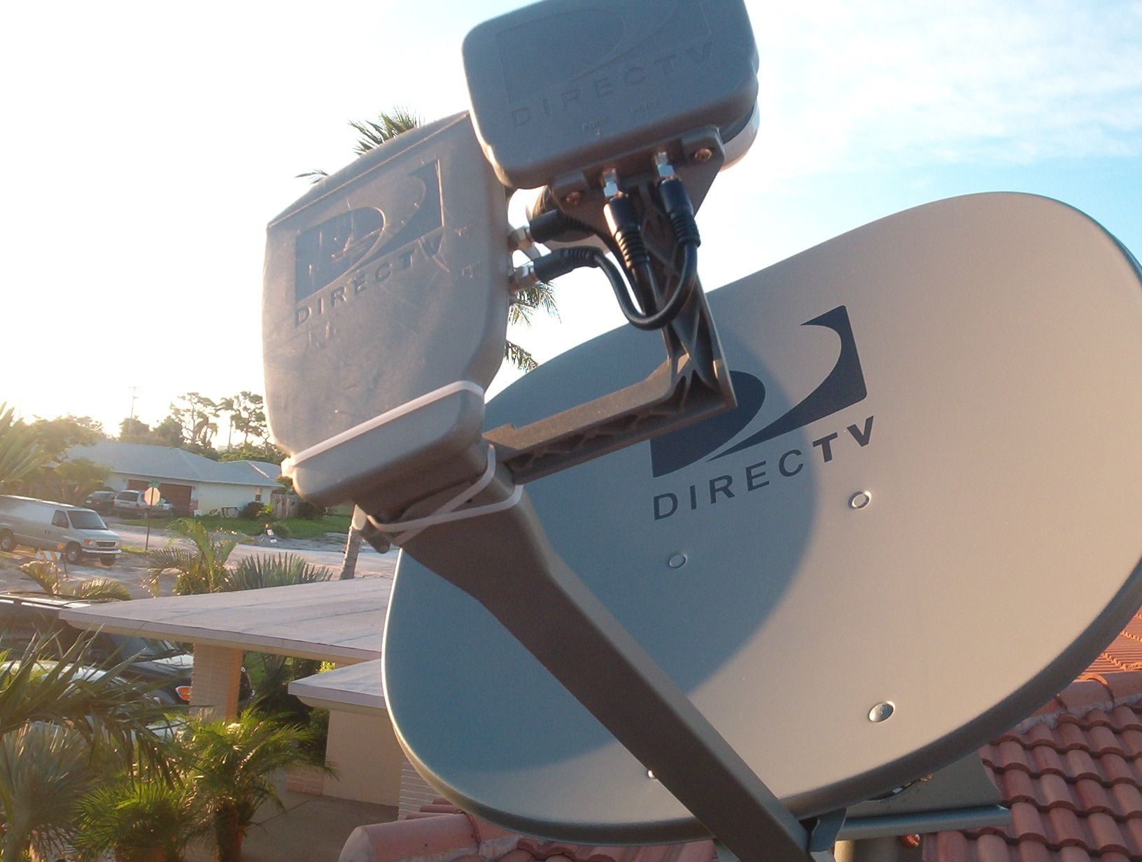

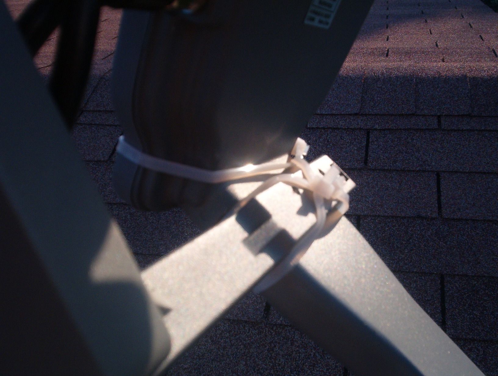

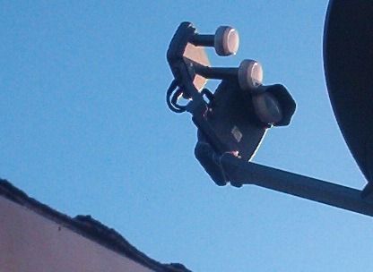

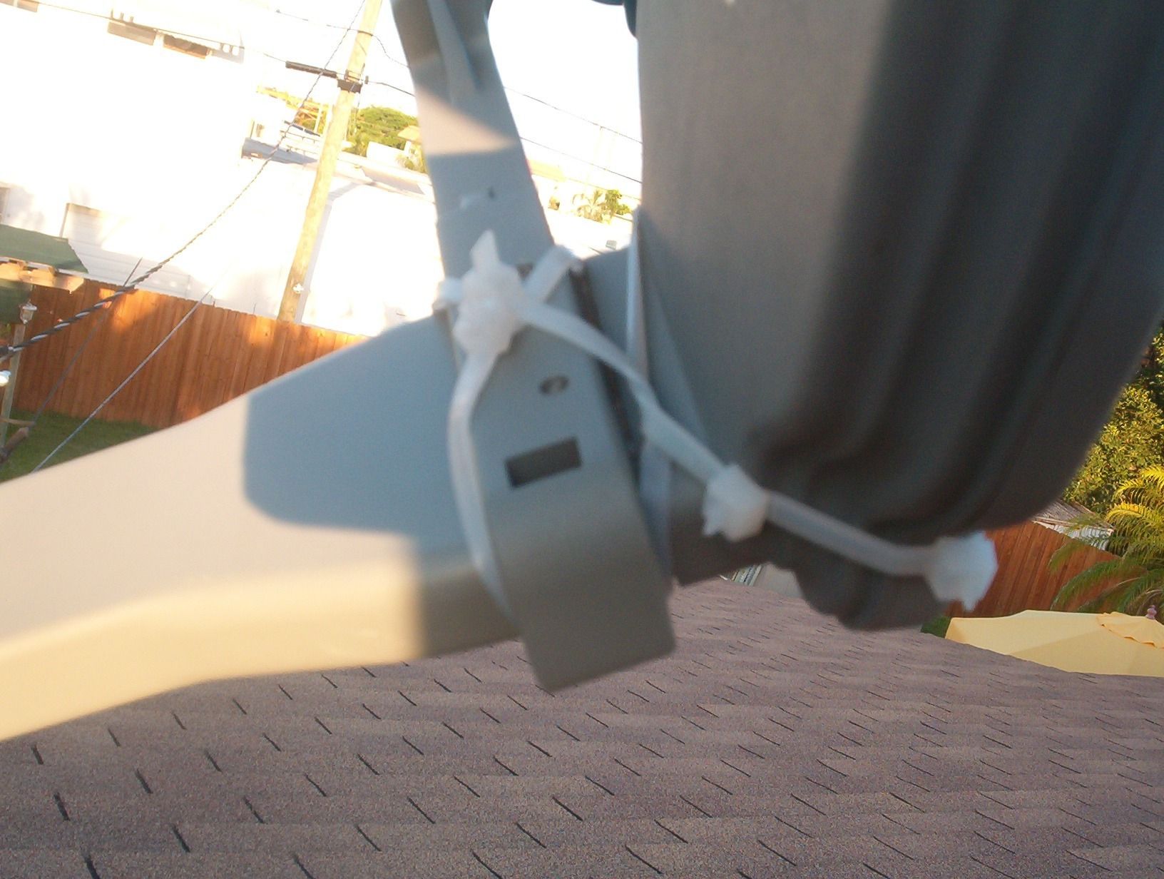

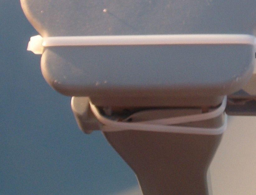

I actually had a AT9 installation nightmare ( you can see it in this thread ) the first installer put a AT9 up and used a LNB arm from another dish, So he couldn't screw it on so he used tie-wraps. When Directv sent out the tech to "fix" this they specifically asked that a senior tech do the work. The senior tech took a look ant told me i needed a new dish because of the wrong arm. The first tech took over two hours to install ( with a wrong LNB arm ) the senior tech took less that ten minutes to install a new dish. I truly think some installers ( at least down in south Florida ( Mastec)) are clueless. I knew i knew more just from reading these post's, I mean who would have thought a LNB arm holding the LNB's on with tie-wraps is correct ? Ive never installed one and i knew it . the tech actually left it and thought i would be fine with it ??? I have pictures on my other post... Everything is fine now. just my two cents worth - :hatsoff:
HEre's the pic's ( i had to share -- :eek: )
The new LNB arm is totally diffrent from the one in the pics

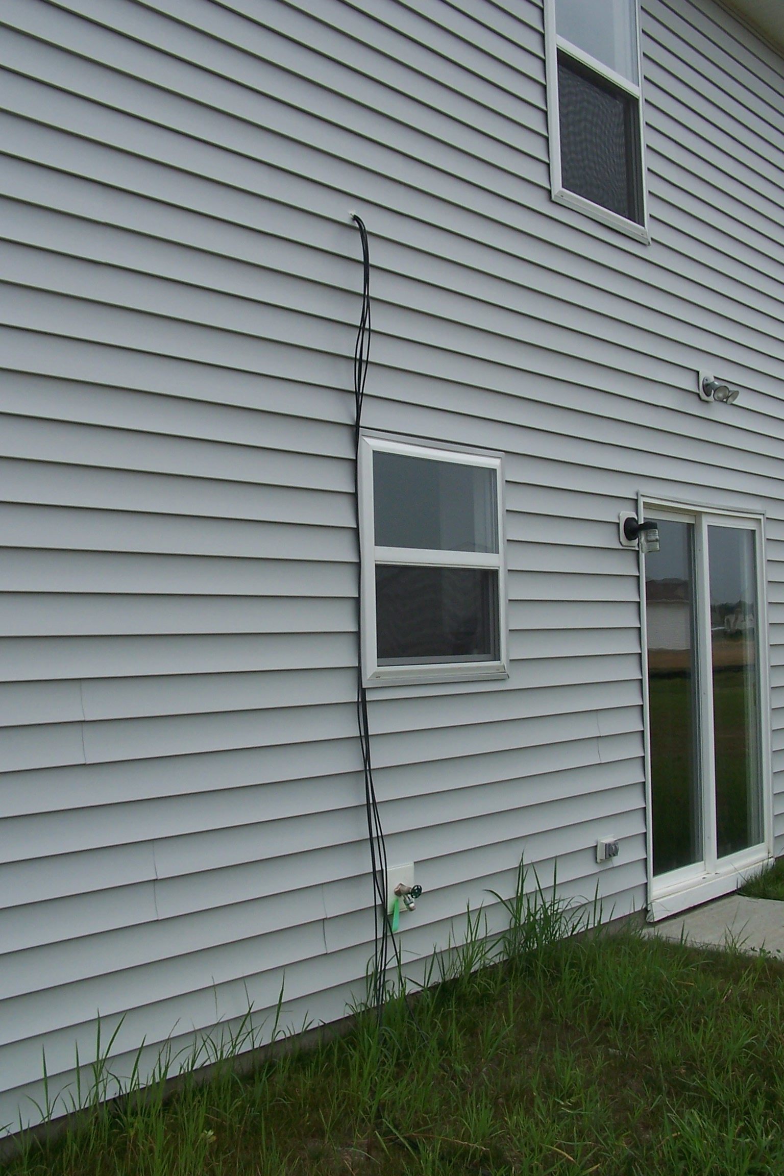

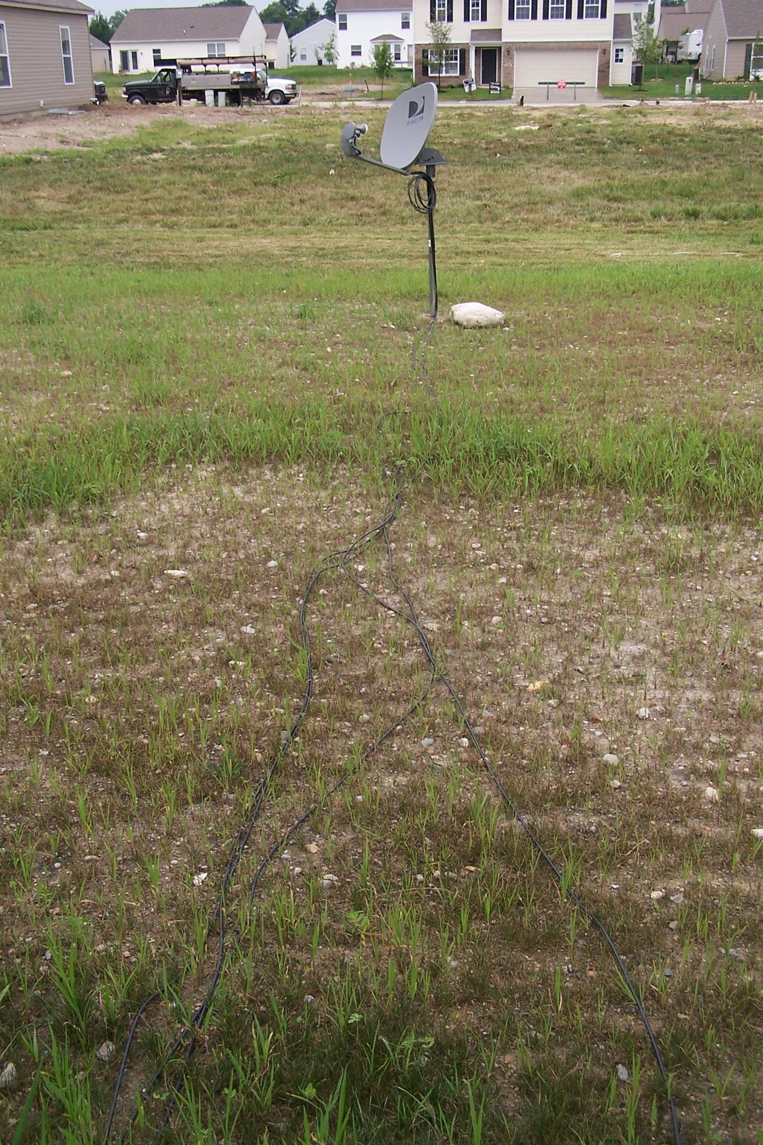

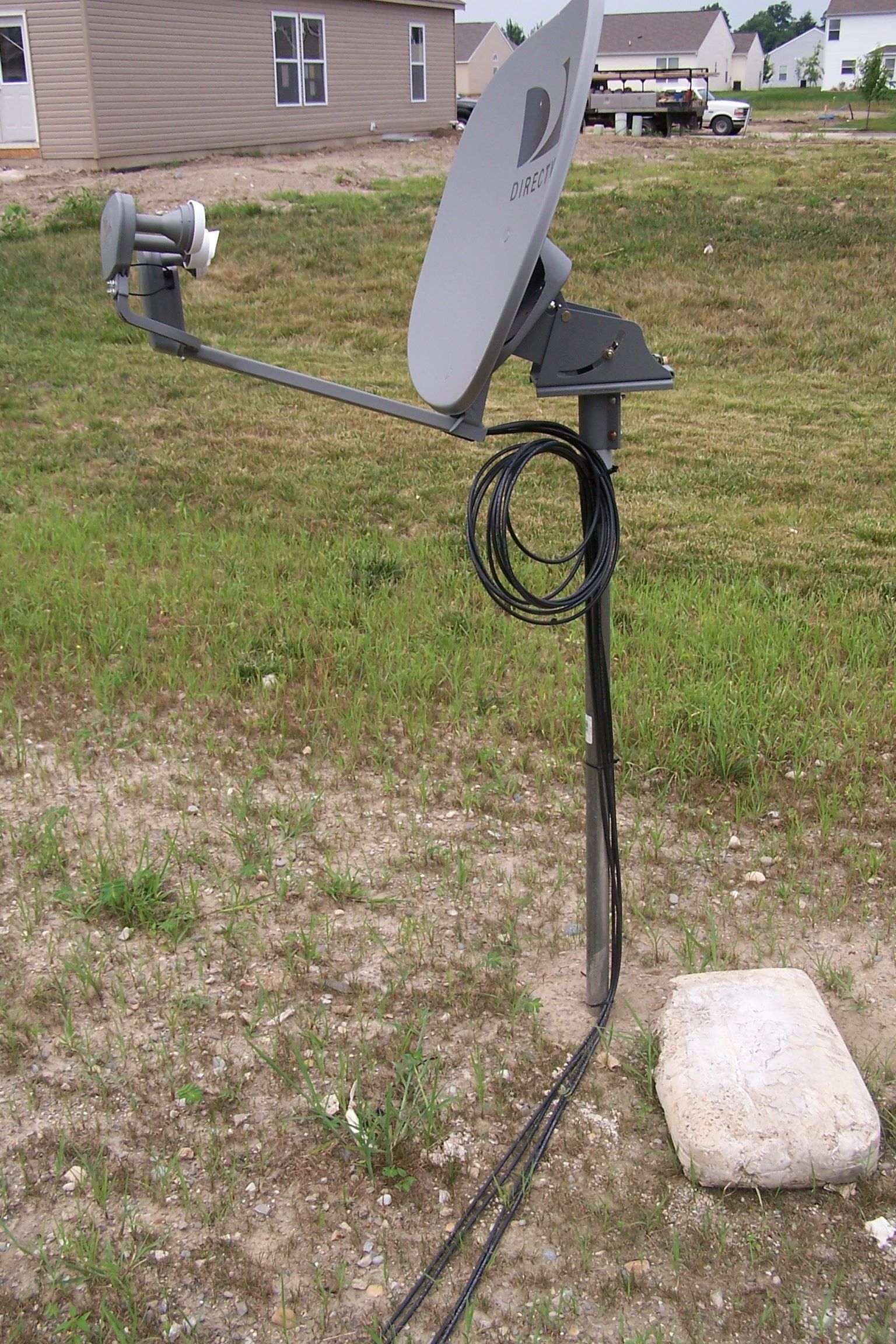

LOL that is the right Arm, but the doofus put it on upside down, and it looks mangled.i'm tellin ya, i've seen gruesome stuff, i carry a digi-cam with me, i'll see if i can figure out how to post pics. i have pics of an install where the installer layed the coax right on the ground,went up the side of the house (no screwclips) and put all 4 lines str8 into the closet in master BDRM. GRUESOME, he also put the pole just a mere 6 inches in the ground.
One thing about those Dishes They Stink, Indy has become the dumping site for all the old Ka-Ku dishes, that dish you have is an Andew dish, Blah. One more thing, the jumpers for the 110 and 119 LNB, they're gonna fail, i suggest you make a couple short jumpers and put them on. or e-mail me you adress i'll make them for you and mail them, sorry i'm not coming out and puttin on for ya too LOL

Man, that looks gruesome ! glad it's not my house. Seems like that dish will blow away with heavy winds & being only 6" below ground. Are you talking about the jumpers on my dish ? :what If so they did replace the whole dish - Im not sure if their the same one's...
Think of the money the installer saved on rooker clips and digging a trench. I wonder what the wasted bag of cement is for?
