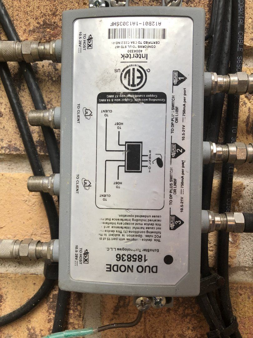

Your two HWS's are probably connected to a dual node which uses all three outputs from your LNB so you'll have to add a DPP44 switch to have an additional output for the Wally.
Doesn't the Dish 1000 DP Plus LNB he is using come with a 3rd output he could use?

Sorry to ask so many dumb questions but will the DP44 replace the duo node I have now?
Sent from my iPhone using SatelliteGuys mobile app
The only dumb question is the one you don't ask. :)
No, the DPP44 will not replace the node. You would wire the dish to the DPP44 then 3 of the outputs of the DPP44 to the node and one to the Wally. You would also have a power inserter connected to port #1 on the switch which I would probably put at the Wally location.
