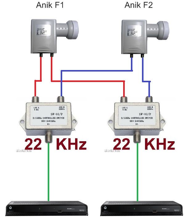

Okay Guys... now i have a little more clear about that... i decided to draw a kind of diagram..i was wondering if you can look at it to see if the set up connection is okay...
That looks good, the red line coming out of the lnb will be for Anik F1 @ 107w.
As for the 22khz switch I use an Ecoda, but I´ve also used a DMS International SW 21K (also a 22khz switch) with good results.

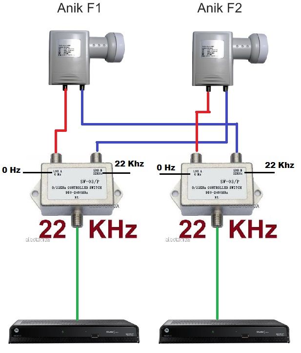

One question... it doesn't matter wich lnb output goes to 0 Hz or 22 KHz switch port?? I guess i need to consider a wiring sequence. the lnb outputs doesn't show a label of port 1 or port 2, So, i figured out the installation switches and the lnb's need to be connected in the same way to avoid system failures..is that correct?? i was reconsidered the installation diagram like this: F1 lnb output A goes to 0 Hz switch port (sw 1) and the other output of that lnb (B) goes to 0 Hz switch port (sw 2), F2 lnb output A goes to 22 KHz switch port (sw 1) and the other lnb output (B) goes to 22 KHz switch port (sw 2)

Sorry I´m multi-tasking here and maybe I didn´t pay attention.
Ok, you will have 2 lnbs one pointed to each sat, you will have 2 swtiches, 2 receivers,
The lines coming out of Anik F1 @107w will have to go on the 0khz side of each switch, thus the Anik F2 @111w signals coming out of the LNB will go on the 22khz side of the switches, it won´t work the other way around.
