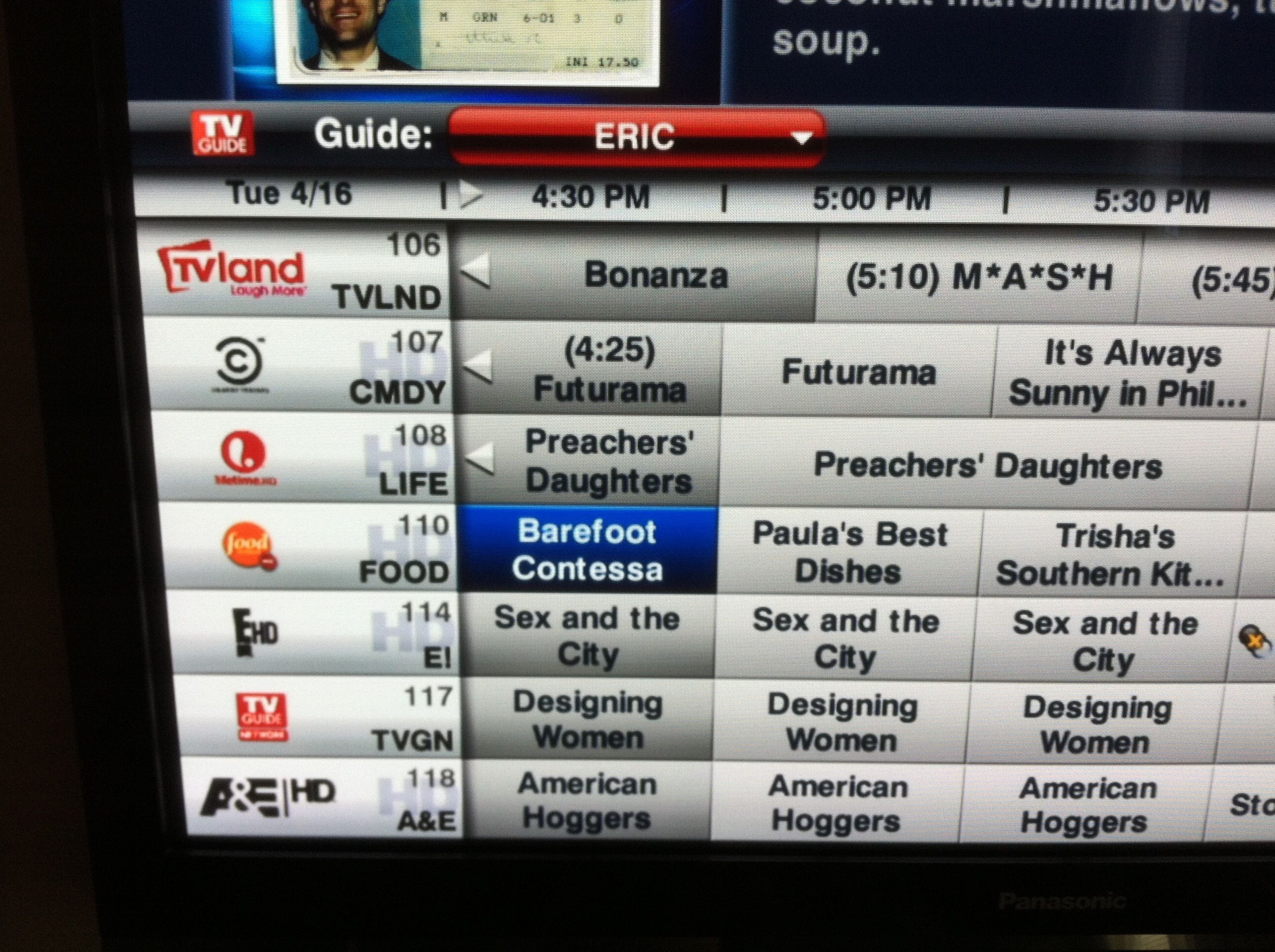

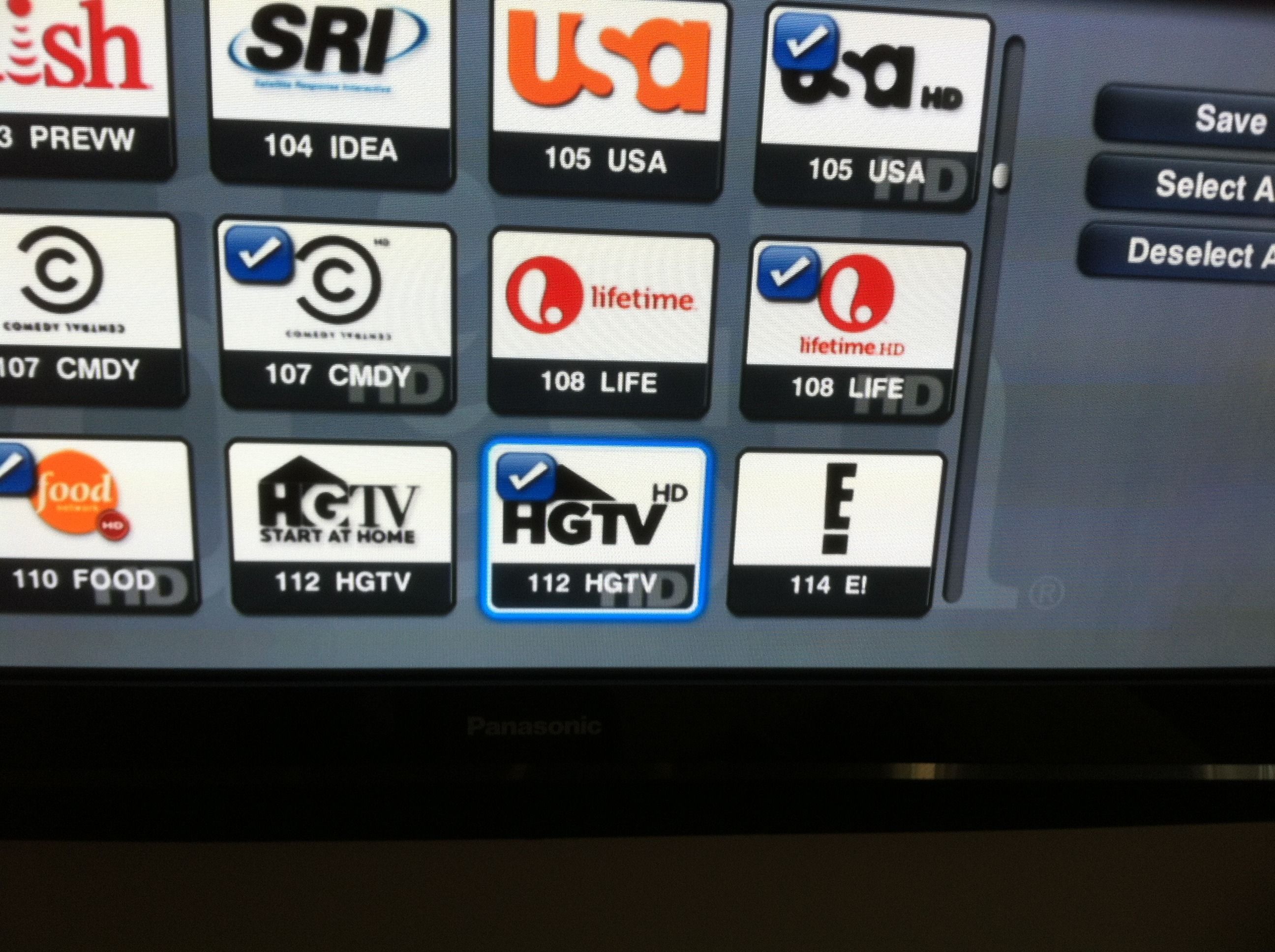

Hey guys anyone else experiencing a channel not showing up on the guide??
I have HGTV HD channel #112 and even select it on the channel guide, but it does not show up in the listing. Very strange! I can manually go to the channel, but just cannot get it on my list.
This is the only channel Ive noticed so far. Ive even waited for the nightly update, reset etc
Thanks for any info.
(and yes, HGTV is for my wife! ...but I do like House Hunters :D)

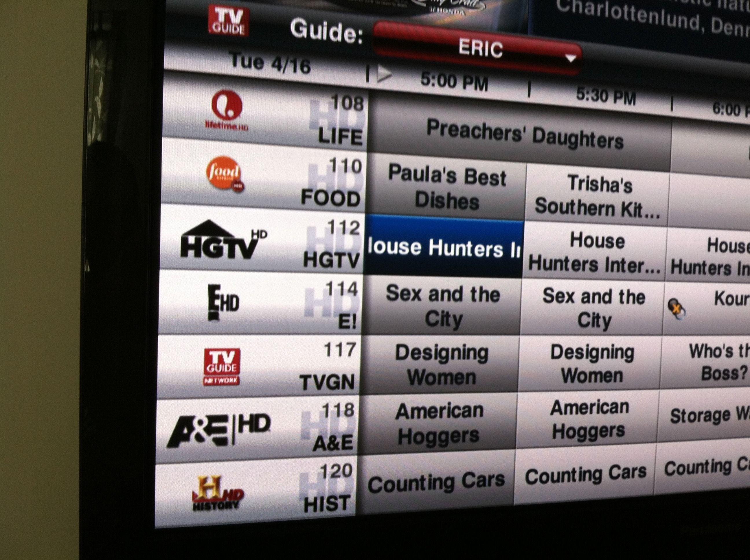

ok this is weird, I cannot get it on my list from the Hopper in the living room but in my bedroom on my Joey its there.
Strange!
Yeah just another bug with the custom lists... Glad I never use them. I just lock out the channels I don't want to see. You should see HGTV on "My Channels."
To me, it seems like you have to add at least 2 channels for one to stick. Add HGTV and another channel you don't care about. Then later delete the extra channel.
Wow this worked.
thats crazy. Must be some kind of bug?
