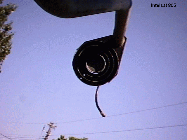

Don't have a choice here. the arc almost follows the power, cable, telco wires here. Haven't noticed any degradation, but then my dishes have never looked at clear sky, so how would I know??

I have a similar situation. My C-Band dish points to 99W right through a 5KV power line - just like you show in your pics. I can not attribute any problem with interference to the power line. I believe any noise from the line would not be within the frequency range to be a problem.
