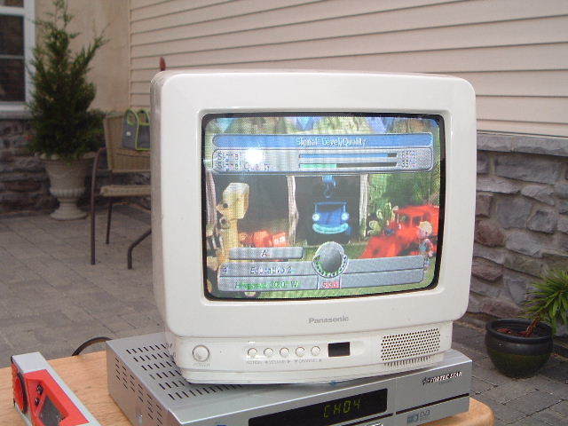

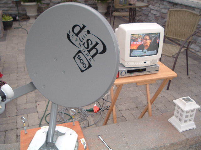

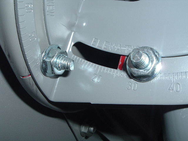

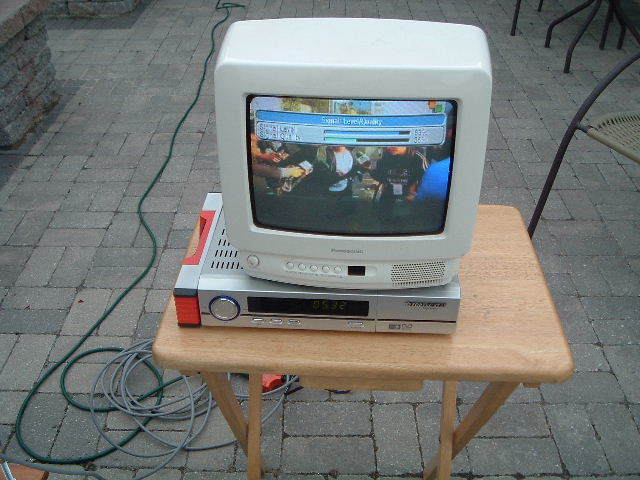

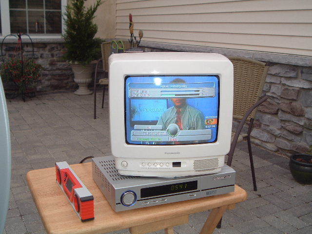

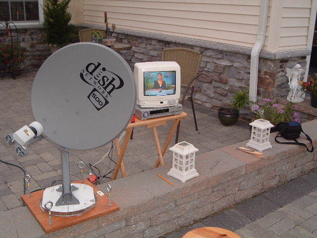

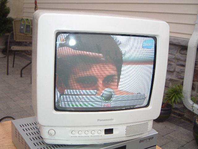

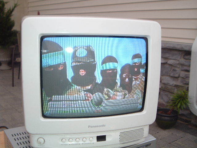

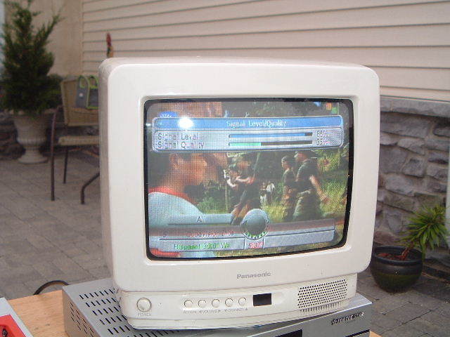

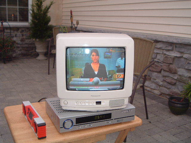

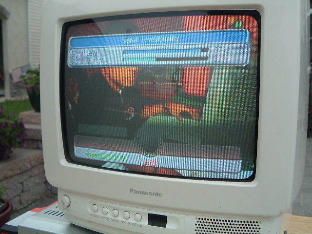

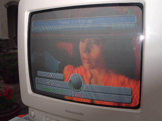

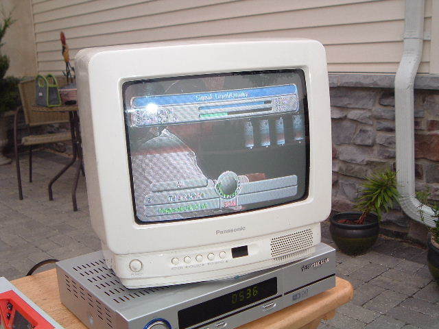

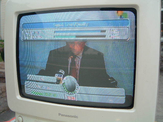

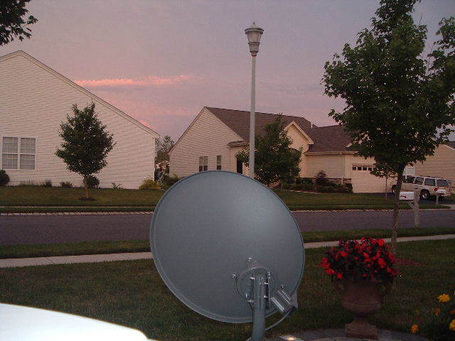

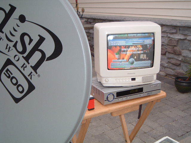

After reading this thread and having nothing to do. I decide to see if Hispasat at 30ºW was doable on a 500 Dish, I mounted a Invacom Universal Single Ku 0.3 dB LNBF SNH-031 on the Dish and set it up as per Dishpointer.com.
I managed to get all but one transponder that was originally locked in with my 90 cm motorized system. Here are some pictures of the set up; I had a LOS between the two houses across the street from me. I got all of Cuban and Spanish stations including Zoom, Press TV, and almost all of the Arab stations as per Lyngsat. Love FTA!!

The OP will be glad to hear it. He is listed as in NJ as well.The real test is will a sprinkle take it out, or will it hang acceptably compared to your motorized setup. We expect a detailed report from the next few rain events in your locale.

Keep in mind you could still have inclimate wx conditions take it out, even if the storms are only east of you, between you and the sat.

I am not familiar with the Viewsat Ultra; it should work well on FTA. I want to tell you that to try and receive Hispasat for your first try will be a challenge as the setup is very sensitive.
My first suggestion if you have not done this before is try and get your true south (TS) satellite first that would be Horizon 2 at 74º west. It has one station on it which is Ohio News Network ONN. The transponder is very strong, check out Lyngsat.com for the transponder information. And check out dishpointer.com for line of sight (LOS), azimuth, elevation and skew. After you lock in ONN, try going to AMC 6, there are two transponders to work with; one is the NBC Mux and a religious station. The trick here is to try and get both at good quality level. If you lock in the religious station at a very high signal level the NBC mux will be very low you need to adjust the dish so that they both come in good. Next swing over to AMC 5 at 79º west, there are some strong transponders there, the trick here is there is a Spanish station very strong with good signal quality (SQ), but it takes time to lock in a picture. For some reason the picture and signal are very slow to show up on the screen this happens some times.
By the way (BTW) you would not have to change elevation setting or skew as these sats are very close. If you become proficient at aligning these sats I would think you would have no problem getting Hispasat.
