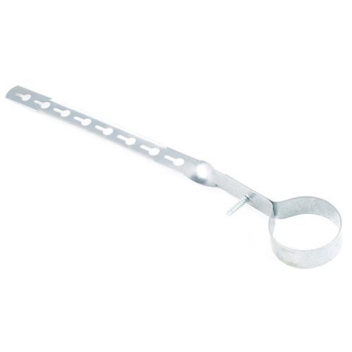

Thanks for all the photos.
Can you take one more showing how you mounted the LNBF on the dish and what you used? Thanks
Here is the e-bay url for the holder this is what I use. I will post a pic tomorrow.
http://cgi.ebay.com/Universal-Single-Dish-LNB-Bracket-LNB-Holder-LNB-Mount_W0QQitemZ280376473288QQcmdZViewItemQQptZLH_DefaultDomain_0?hash=item4147bd76c8&_trksid=p3286.c0.m14

I will try this next
image at bottom
1 1/2" pipe hanger from whatever hardware store you like

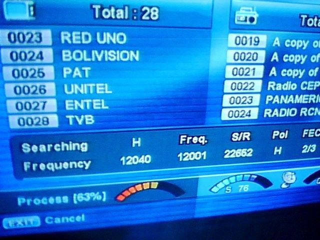

Findings at 22w.
Thanks guys for the info on Eastern sats. Somehow they're often left forgotten, probably because immediate Ku-band sats east of 61.6W aren't that friendly to NA viewers. :)
Here you go Zamar, I scanned this bird earlier this morning.
Happy "hunting".
