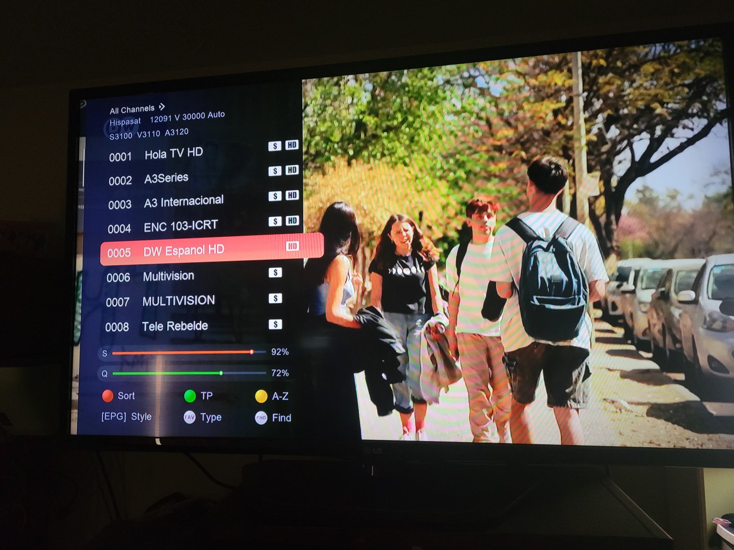

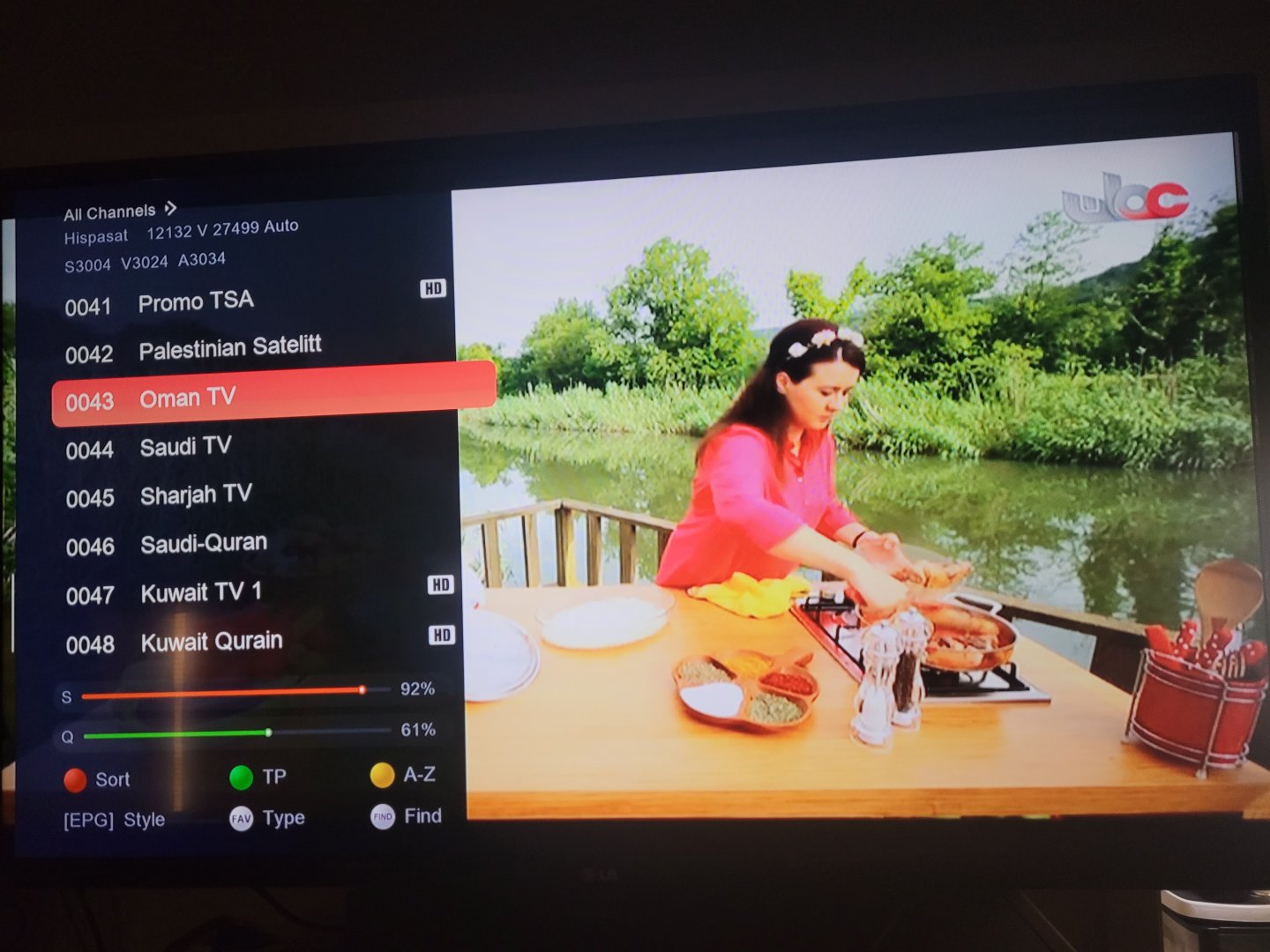

EDIT: Why are both 12132 and 12091 shown as V in your receiver, as both are H?
It is the way scans on the receiver Gtmedia v8x maybe my lnb orientation is on the wrong side?

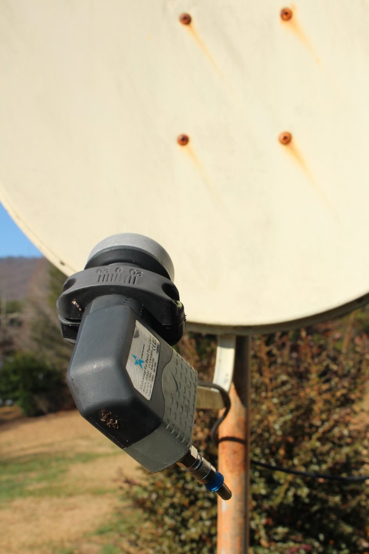

Yes, the orientation should be on the other side so the LNB is leaning like this: /
However, as long as you are getting satisfactory signals on the transponders, and don't mind they are opposite polarity from what they are, there is no real need to change it (especially if the dish is hard to access).
