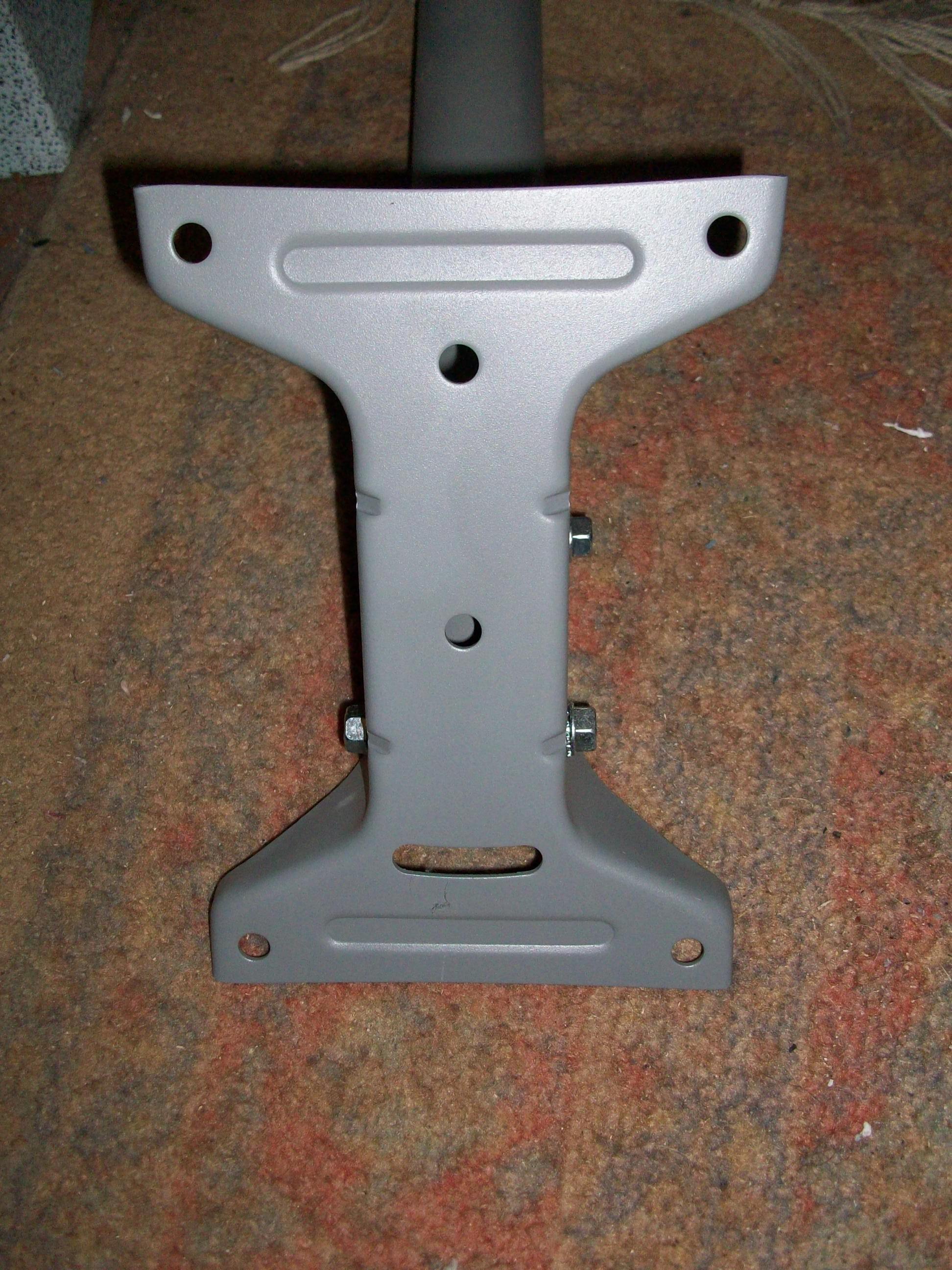

Yes, the footprint / base? I have a plate mounted on a pole, I could have new holes drilled and taped for a DirecTV dish.
I have a 1 5/8 pole already cemented into the ground, I can remove the mounting plate easily.
The holes form a rectangle 5" x 7 7/8". There are also holes in the middle of the base that are 2 3/4" apart.
The holes are 3/8", and yes the measurements are center to center.
Here is a shot of it oriented correctly.

They do make an adapter to slip over the 1 5/8" OD pole to allow use of the Slimline's 2" OD requirement. Therefore, no jury rigging needed.

No, I meant base. The base for the 1 5/8" mast is much smaller than the one used with the 2" mast. I don't think it's strong enough for the Slimline.
What I'm saying is that the base isn't needed if you use a pole mount. Just slip the dish onto the pole and align it. That's what the size adapter is for.
Using that adapter to resize the J mount is definitely a bad Idea, but the monopoles might help with the support.
If the op uses the adapter on the pole he mentioned then it might hold up, but he also talked about using a j mast. It wouldn't work well in that case because of the smaller base compared to the 2" mast/base.
