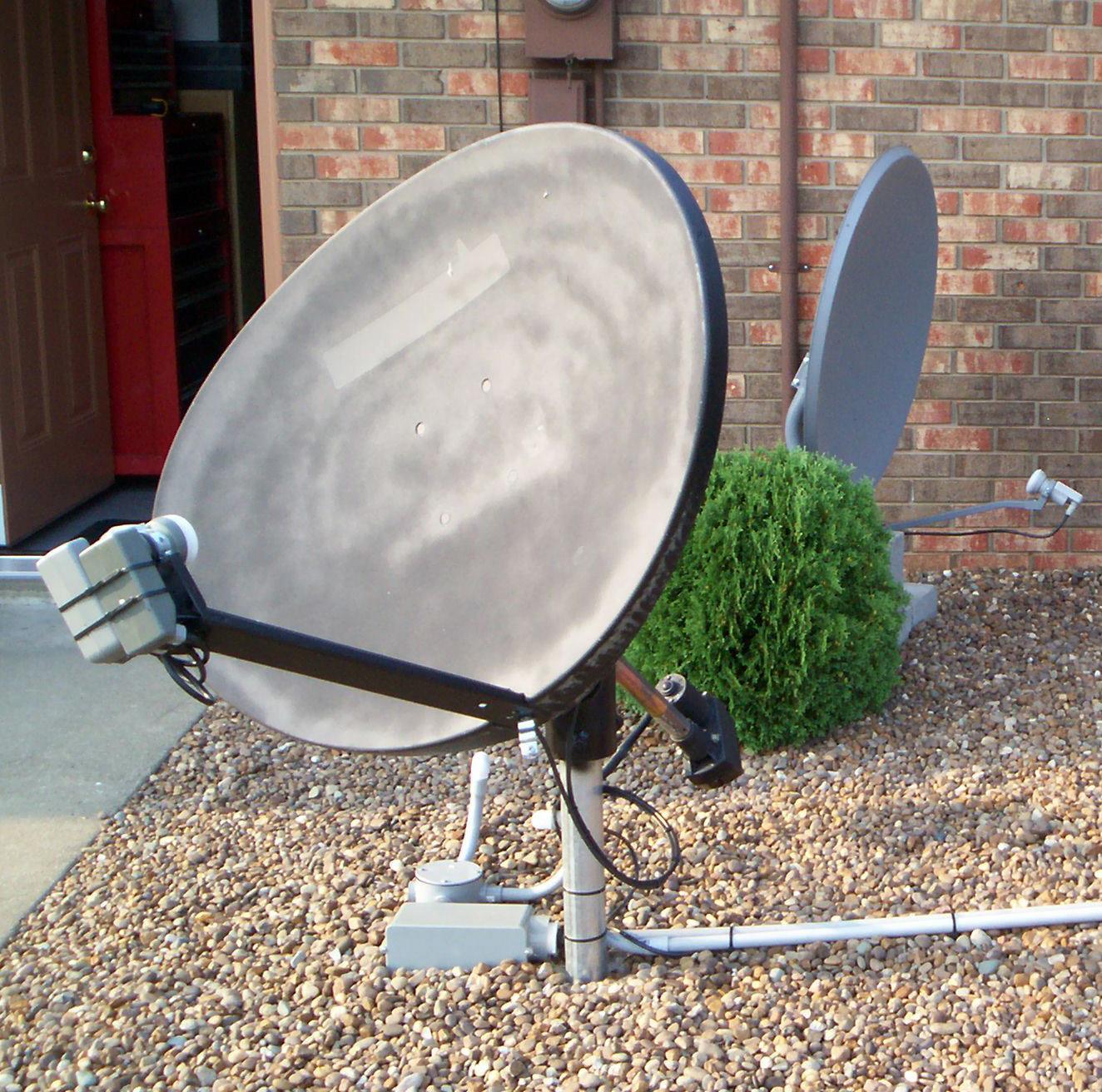

The wood was only to space out the degrees. I needed one to bolt a DBS LNB to my StarChoice dish which sees 107.3 & 111.1. Put a 1/2 inch piece of wood next to the 111.1 LNB for 119

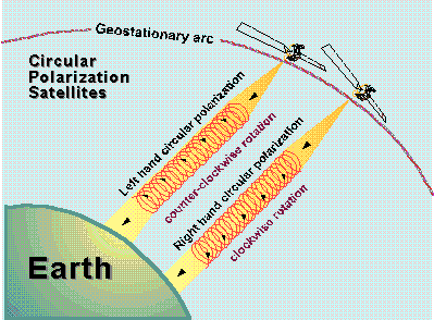

Remember also a Circular LNB can be used upside down, sideways anyway as the signals come down in a spiral!

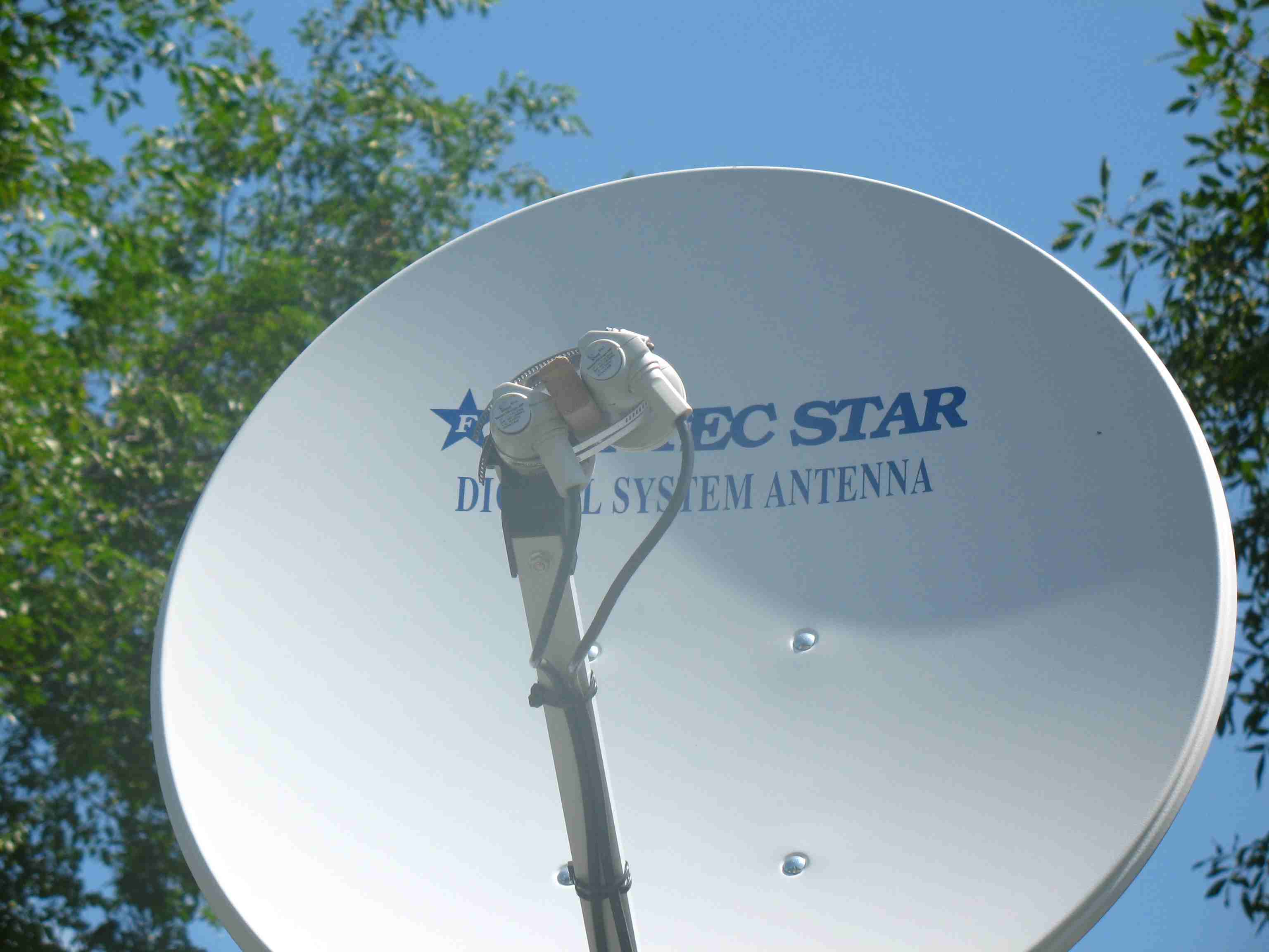

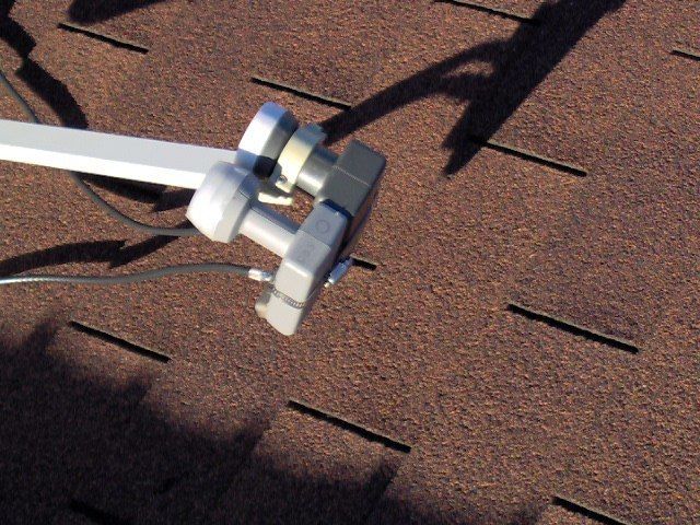

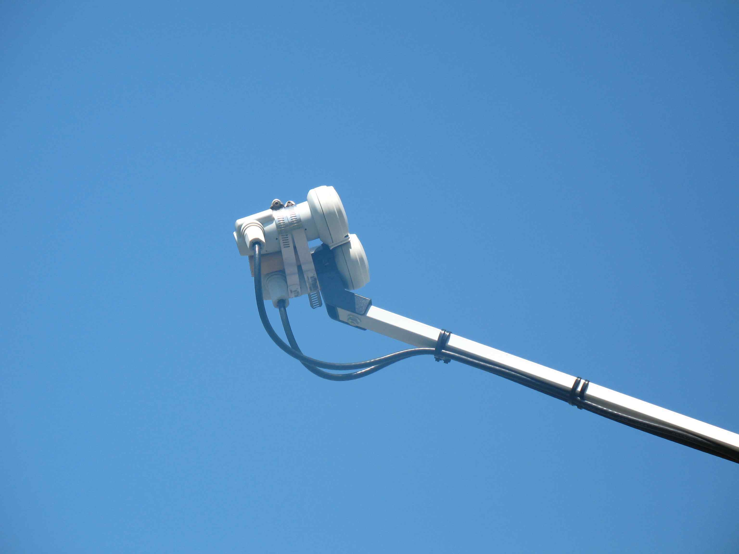

Here ya go! This is for G10 and IA7.

You can't tell in the photos, but I had to add a small thin piece of plastic in between the the lnb eyes so that the lnbs would be aligned properly.

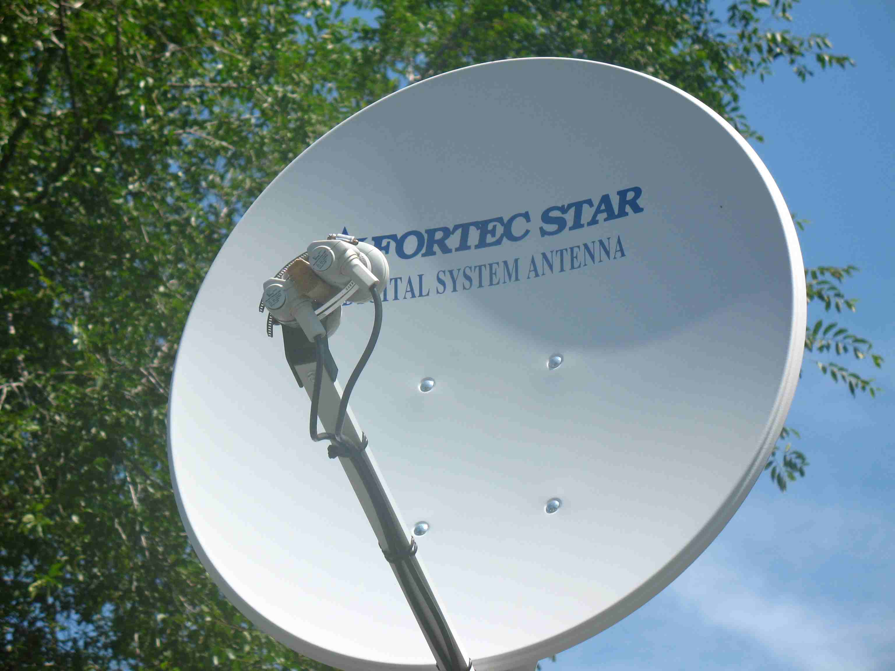

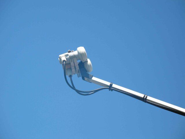

Plastic tie straps work well also as seen here on my P* dish. I moved the side lnbf around a little to find the strongest signal and then tightened the tie straps. Use at least two straps :)
The center lnbf is linear, the one strapped to the side of it is circular.
You can't tell in the pic but the side lnb is angled toward the center of the dish. This angle/spacing depends on the dish you are using of course.
The side lnbf is 4 degrees off from the center one. That way I can get G10 and E7 at the same position. And if I move to W3 I can get Ni2 on the circular.
I've been looking for something more "permanent" but so far the straps are holding well.

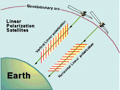

i'm not trying to hijack this thread or anything, but how to regular fta signals (linear polarity) come down? are they straight lines, going from the sat. to the dish?
Yes :) That's why skew is so important, you are actually lining up your dish/LNB exactly the same as the satellite in the sky!
