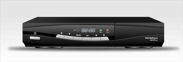

The new GEOSATpro HDVR1200 HD/DVR receiver will be released next month with full Glorystar experience. It will feature automatic channel updating and also allow the user to arrange their own favorites and add additional channels that will not be erased during the automatic updating process. The system will be HD and DVR capable, but will be sold at the price of a standard system!
