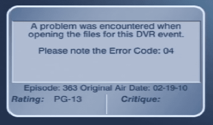

One of our recordings gave us this error today:
"A problem was encountered when opening the files for this DVR event.
Please note the error code: 04"
I've attached a picture of the message as well. I have unplugged the DVR for a few seconds and plugged it back in and still get the error. We haven't had any other issues or glitches that I have seen in the past with HD failure. So I am hoping this could be a one time event.
Any thoughts are appreciated!

That error indicates file corruption for the one specific event if you are lucky, or a general bad condition of the whole drive if you're not. Good luck!
That's a good link Bobby posted.
Error 04 (not 004) is:
Symptom
Errors 01, 02, 03, 04, 05, 06, 07.
Cause
A file error occurred when a DVR recording was interrupted by signal loss or power failure.
I am a little less worried about the HD now.
