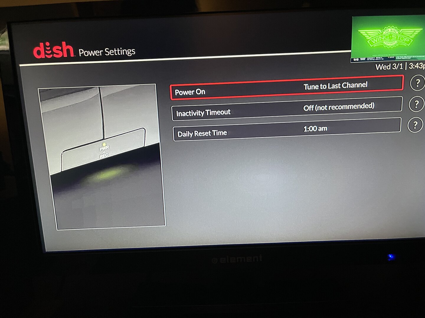

On my Hopper 3, go to Settings, Power. Have selection for how many hours of inactivity before reset, and selection for hour of reset.
READ the third line of the photo of the Hopper 3 power settings.
It shows daily rest time!
