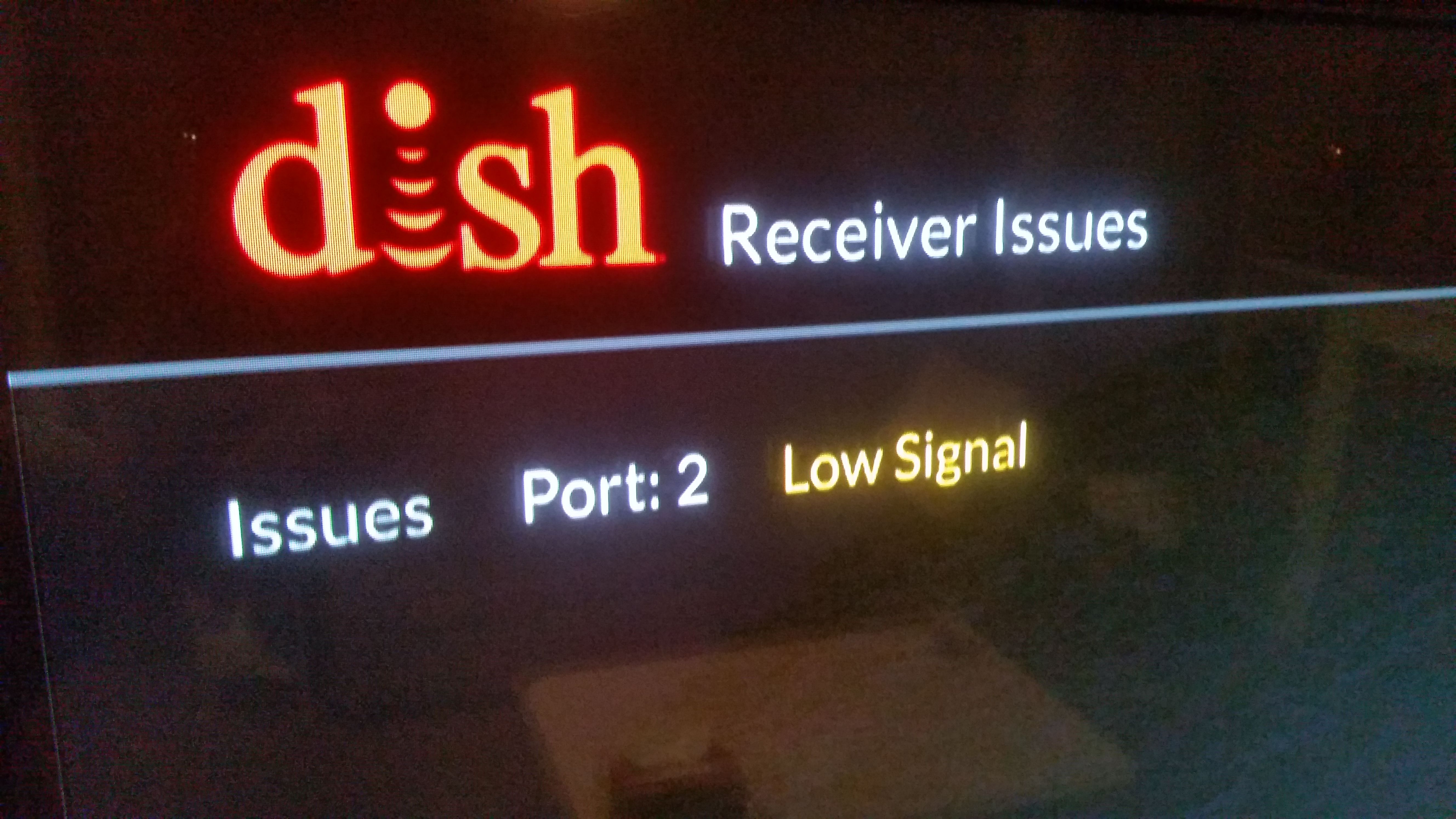

Hello... I had my hopper 3 installed on February 13th still not getting any DVR images.. When I run a diagnostics test I'm getting an error "Port 2: low signal"
Can someone please explain this to me? Thank you
I don't think that is a real issue, since port 2 is not currently being used.
Mine will indicate the same error, but my Hopper 3 is operating as it should.

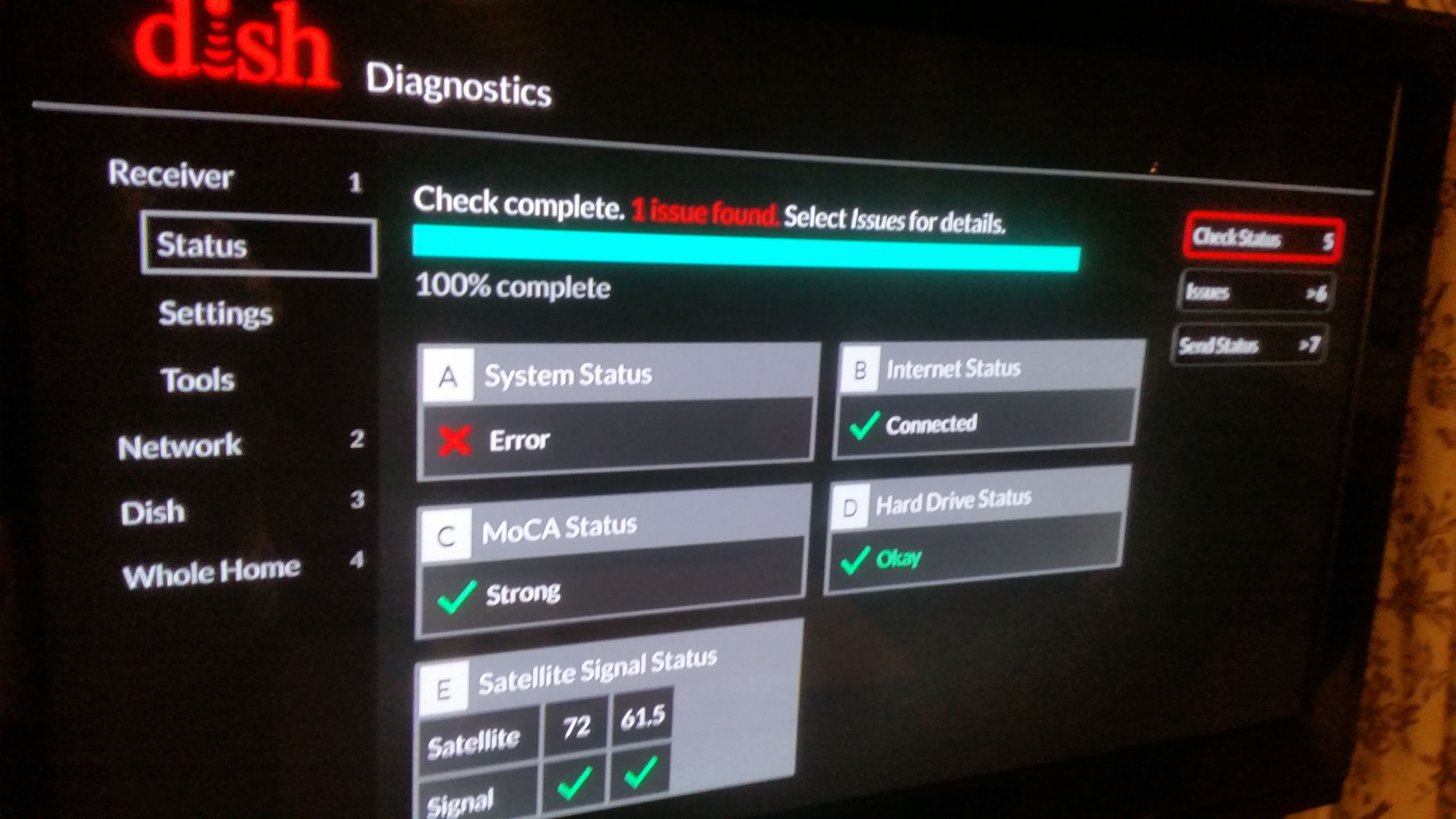

Try going into the "Report Status" screen and running the three phases of tests. You may get more information about your "Low Port 2" issue.
I have the 1000.2 EA Hybrid setup (61.5 & 72) as shown on your screen. My setup shows no issues. You may also try looking under the Dish page of the Diagnostic menu to see if there is anything out of sorts there.
You shouldn't be getting that error. To confirm I just ran the Status test here and it didn't indicate any errors at all. You should check the signal levels on 61.5, which is probably what is referred to as Port #2.
I did the "Report Status" test and didn't get any information about my Low Port 2 issue....is this something I should call Dish about?

Interesting. I did have that error on my H3. The tech came out and did the following: replaced some cable ends, replaced the hybrid LNB, replaced the Hopper 3. The error still exists. All signal levels are very good, including the 61.5. Everything works, but that error does not clear. I have been his only H3 install so far, so he could not report on whether others were experiencing the same issue. He only replaced everything because his supervisor told him to do so for good measure.

Tech just left my house..He plugged his phone into the front of my Hopper 3 and said " all the signals look good" and he is going to have to show the information to his boss in the morning and come back..

Saturday 1:00pm tech is here now...He just changed the Dish to a smaller one and ran new wire directly to the Hopper 3..still having low signal problem so now he's swapping out to new Hopper 3 receiver.. I will update later today...
