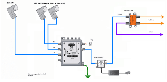

Currently customer has hopper 2000 and 4 joeys and my workorder tomorrow calls for a hopper 3 and 4 joey 3. Problem is they have two dishes due to alot of trees. A DPP500 twin to get 110 and 119 and a single lnb to get 129. I am going to have to run two dishes but question is how since it has to be hybrid.
Please help. If you have a wiring diagram that would help also.
You can wire both dishes to a DPH42 switch then to the Hopper 3. The DPH42 is the Hybrid switch.
Run the 2 cables from the DPP500 to ports 1 and 2 and the wing dish or the 129 into port 3. Power inserter can go before or after the hub
