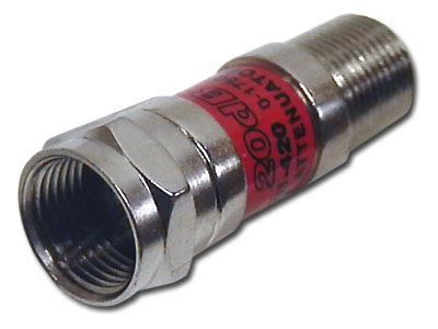

Did you see the following post ? I had the same problem, viewing live OTA was fine, but recordings were all broke up. I installed a 10db inline attenuator to the RF input of the OTA USB module and my recordings are fine now. I was getting reading of 100% signal before and I still am but the recordings are perfect now.
After hours of trial an error I found that the issue is due to a software issue. The Over the Air code that deals with Multipath. My Hopper WS was perfect all the time.
If the signal is TOO STRONG, you get this issue as there is too much multipathing going on. (same signal bouncing off other houses or trees coming into your antenna slightly behind or different).
Solution was to put an Antenuator on the Anttenna coax and adjust it.
Trouble is this sginal can change from day to night so you have to adjust it a lot.
If you do not have an Atenuator putting a 2 way splitter or have a 3 way can be a low cost easy test to verify this.
Hope they fix this soon.
WORSE NEWS: The Joey 2.0 and Joey 4K make the Multipathing even worse, so you may be a minor issue going on with the HOPPER 3 you may not see much of an issue on a Hopper 3, but watch the same channel on the Joey and wow it is even worse. I am guessing the software for the Joey for OTA view is different.
Here's one, I purchased several of different values. I also have an amplified OTA antenna.
Fact is an attenuator or adding a Two way or Three way splinter does help.
This tells us there is a Software Issues with the Over the Air software.
Reboots also seem to help. I am thinking bug in the software with a memory leak.
I sure hope Dish fixes this issue soon, one should not have to go out and by an Attenuator.
This all worked fine on the Old Hopper WS and Hopper 1.0
The thing that is odd to me is, with regards to the attenuator, that my local Fox which I only get 70-75db anyways, still breaks up. I get attenuating one that is maxed at 100 because it sometimes causes issues, but how would that help me with a channel sitting on 70 to begin with?
Come to think of it, I have a 3-way at the house that is -7db, so I will give it a shot. If it works and it takes them awhile to fix, at least I can enjoy the recordings...
