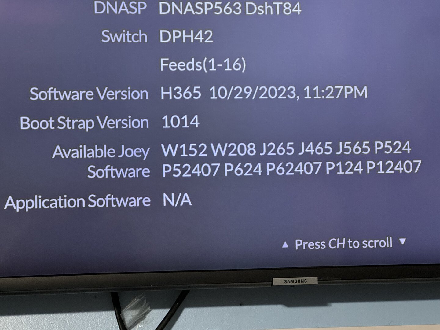

Hi there for the Hopper 3 should the Application Software be listed as N/A since I assume the P versions under Joey software mean that it's all set to go ahead and plug in the Hopper Plus. The tech left it downloading overnight as it got stuck on the download and we figured out a workaround to get it back to Hopper mode without a reset (blue screen then skip back recall skip back and then it reboots around 4 times and goes back into hopper mode without plus).
So just wondering is there a way to force an application version download or should it be at N/A when it's updated to H365 the tech said that it's not preloaded since they only had one preloaded hopper on their truck.
Just want to get the hopper plus working like it was before we added eastern arc since after we added eastern arc the tech swapped everything out to be 100% sure it's working.
Thanks!
Once downloaded it will automatically update if it's a newer version. As far as I know there's no way to manually trigger updates for android receivers.

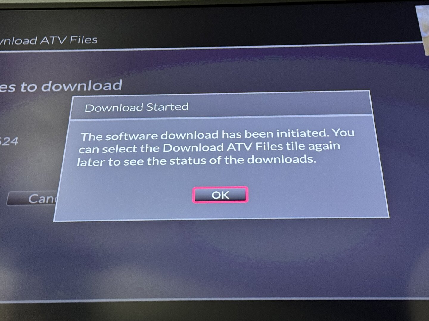

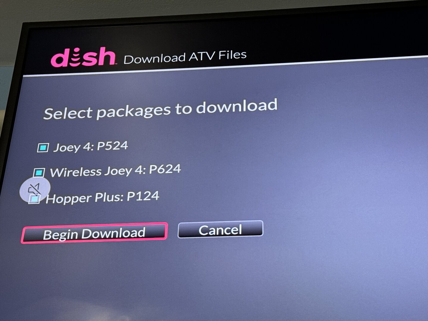

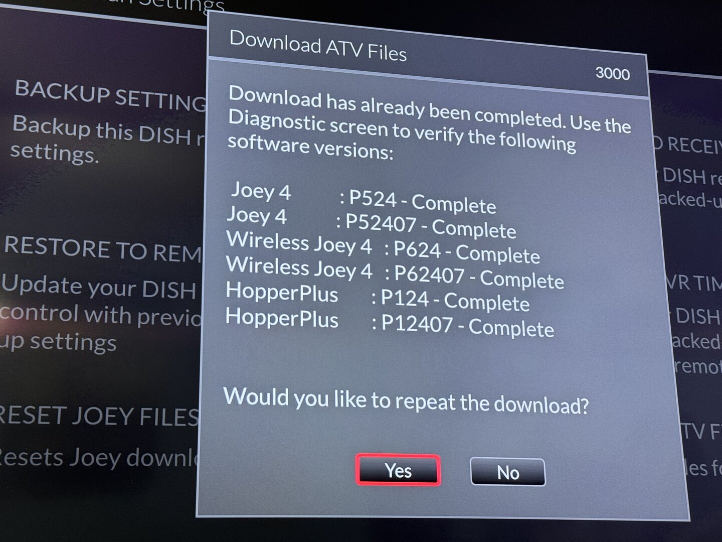

While on the subject, can the downloaded ATV files actually be used to update the Hopper Plus? If so, how does one actually do the update as it seems to be downloading P12406.
I did it here under download ATV files
Specifically the download on the hopper plus takes overnight not sure if it's because it's downloading via USB 2.0.
Although my hopper plus wasn't preloaded

Leave it in standby for ~15 minutes and it should start the download (if a download is necessary/needed)

As for the download, does it make a difference if one downloaded the latest ATV files first or not before putting it into standby?

Yes, when my Hopper Plus was installed back in May 2023, I had downloaded the ATV files for the Hopper Plus before the tech arrived and even with that, the Hopper Plus after the tech arrived still had to do the download, not sure was it because I think I downloaded P116 originally and P117 was released on the date of the install. The tech left in the middle of the download process and I did the installation to completion so it took an hour total from the time the Hopper Plus was plugged in. My question is how does one actually update the Hopper Plus's software since mines is running on P11701 and apparently, P12407 is now available when Download ATV files downloads successfully but how does one actually update the Hopper Pls to the P12407?
Technically no it doesn't matter - if your receiver is in the targeting range (at this point it would be) for new software if you leave it in standby for 15 minutes it should update.
If your receiver is outside of the targeting range for new software (will be the case for android receivers going forward but was not the case previously due to such a small population) then you could attempt to force it via update software tile in the diagnostics screen.
The download ATV files tile exists as a fail safe for installers in case the files aren't present on the hopper for whatever reason (used to be a bigger issue, not as big now but i'm sure it still happens from time to time).
As far as standby - just press power the dream screen (screensaver) is android's version of standby.

I kept thinking the ATV files were needed in the past because the techs didn't have it on USB like they did for the non-Android TV clients.
