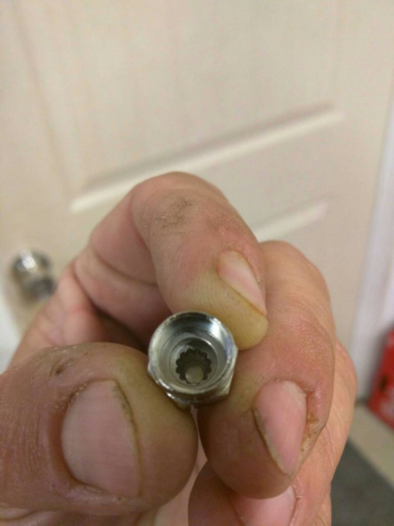

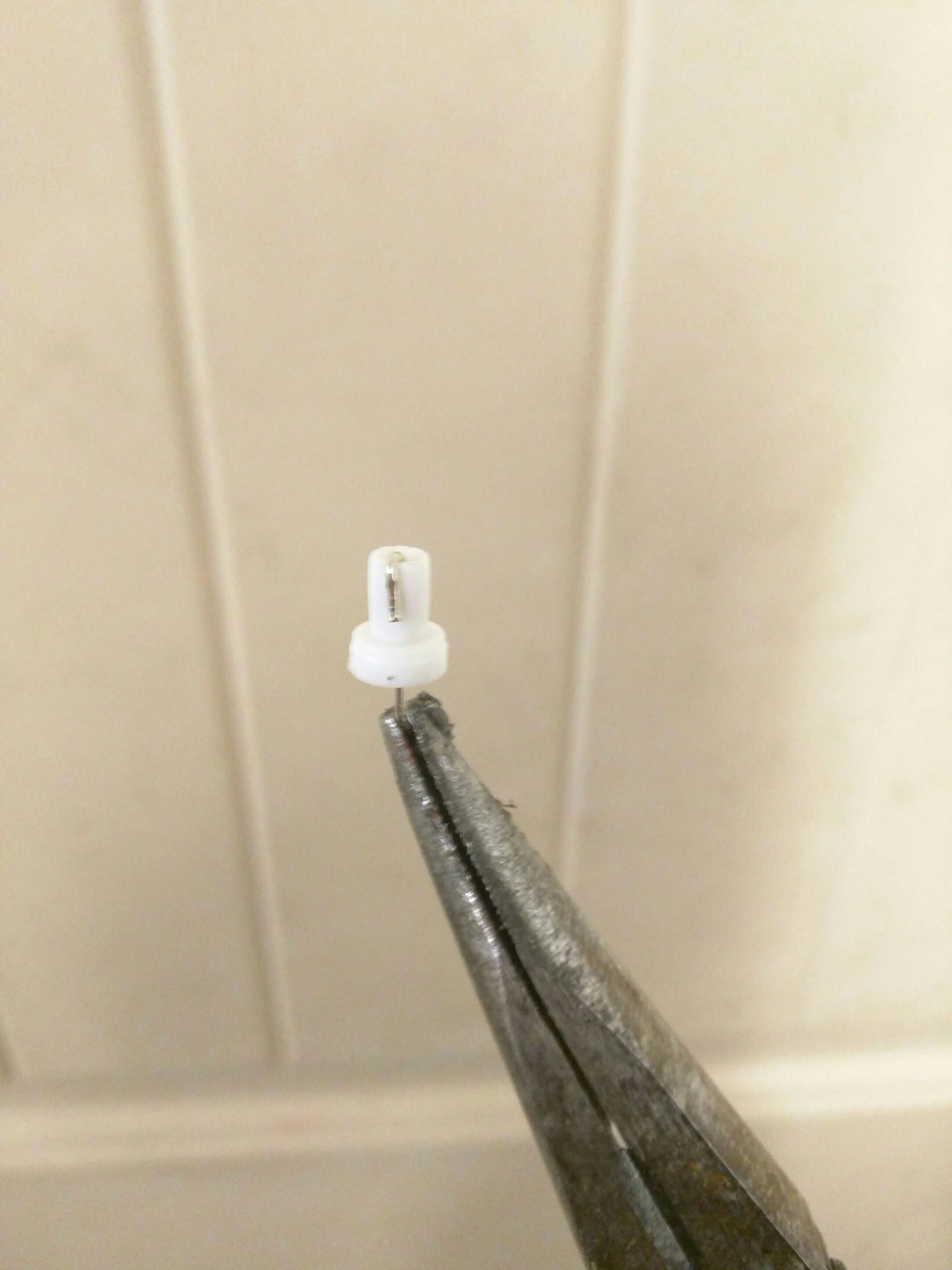

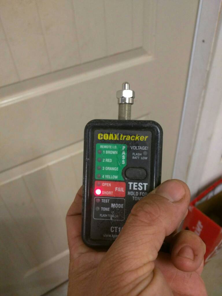

Pull out the rubber and you will see the stinger does in fact touch the outside
I'll bet if you had a piece of cable with a barrel and terminator on 1 end and an ohm on the other. You wouldn't have continuity with 1 lead on the jacket and the other on the stinger.
I've tried that before chasing my tail before I realized that won't work.
