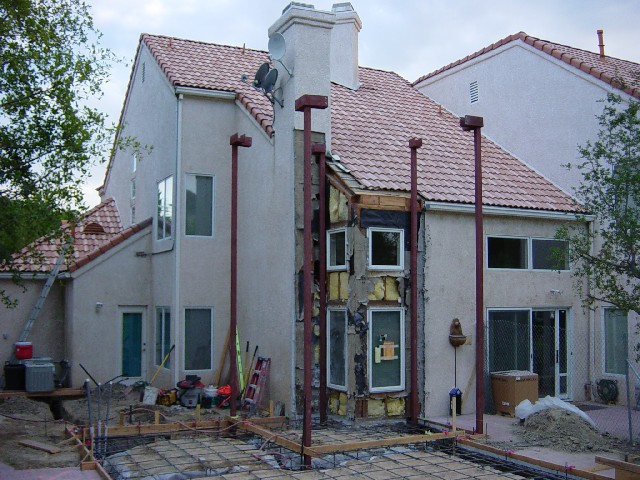

The problem is my cables from the roof go through a conduit LB into the side of an abandoned fireplace chimney*. Then they go under the floor to my equipment closet. Is the installer going to deal with that? I doubt it. They typically hack the cable down the outside wall and drill a hole into the house. I am more than willing to run new cable but will a now mandatory Dish installer work with me on that?
I have also read they will not climb onto a roof. If a standard extension ladder can't reach direct;y to the dish, they won't do the install. So then what? I have also heard they won't allow a Hopper with a VIP. Why? It costs them nothing if they still support the VIP series, which they do.
* I don't want to be flamed with code violation posts over this as I was previously on another forum. There is no longer a fireplace for that Chimney. It was removed for a legacy projection TV which is now a flat screen. Of course I would never run cables down an active chimney

In my case it's not just a ladder issue, the dishes are sort of inaccessible due to a new house addition. You can work on them but I doubt OSHA would approve. But I can do it.
