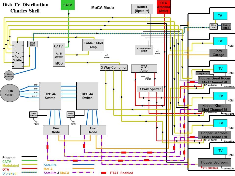

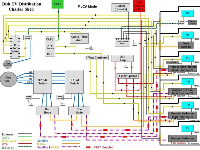

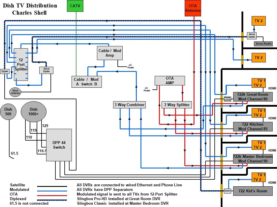

I once had four HWSs at one time. Before that I had two 722s and two 722ks at the some time. Both setups had two DPP44 switches. Correction, only the four HWSs required the two DPP44 switches.
Reactions: TheKrell

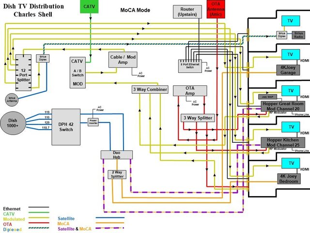

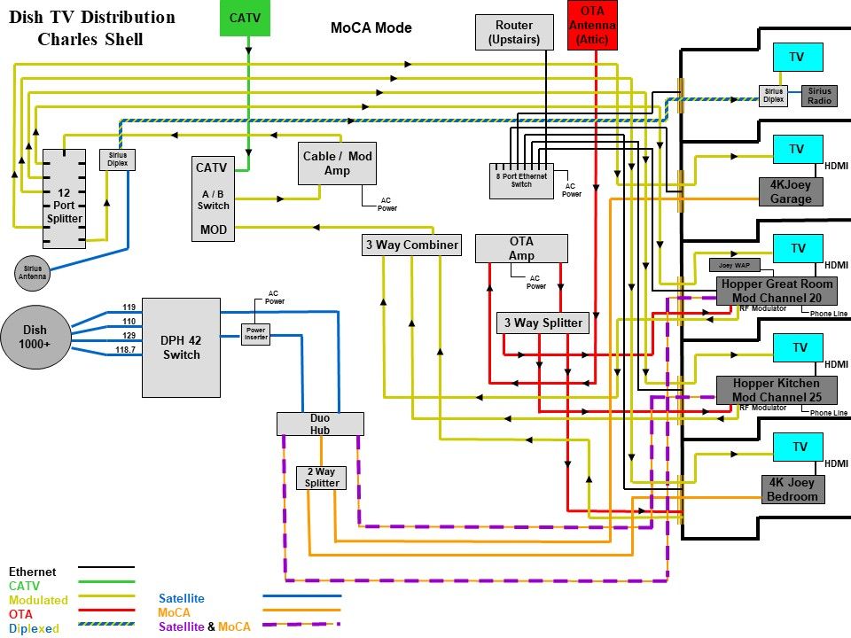

My setups thru the years.
Amber I really don't know what the total limits are on an account but I can say that you can have 722 receivers on the same account as a Hopper 3. I have two on the same account as my Hopper 3. Now it seems the key factor was that the two 722s were purchased receivers. I do not have them all active at the same time nor all running from the same dish. One of the 722s I use in my motorhome and phone in to dish to activate when we take the motorhome out for weekends or vacations and then call and have it deactivated again when we return. The other I use for some of the larger outdoor family and friend gatherings we have during the summer. When I need to activate that one I set up the same portable 1000.4 dish that I use in the motorhome to drive that receiver.
