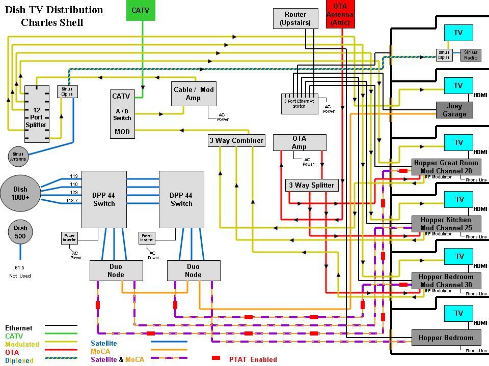

Here is how I have RF modulators in my system to get signal to older TVs. Three RF modulators are connected to three Hoppers. Modulator signal goes to all TVs by coax to a home distribution splitter with the exception of kid's room. His room has a Hopper with OTA module and rabbit ears. All TVs in my home with the exception of Kid's room have a choice of three Hoppers to view. This works out great for all TVs that do not have a Hopper or Joey and also all TVs (including TVs that have a Hopper or Joey) can sync to each other to view a recording together with the exception of kid's room. His room only has one Hopper coax that can't be diplexed. See diagram for how I have it rigged up. Diagram is current with the exception of Kid's room now has OTA module with rabbit ears.
