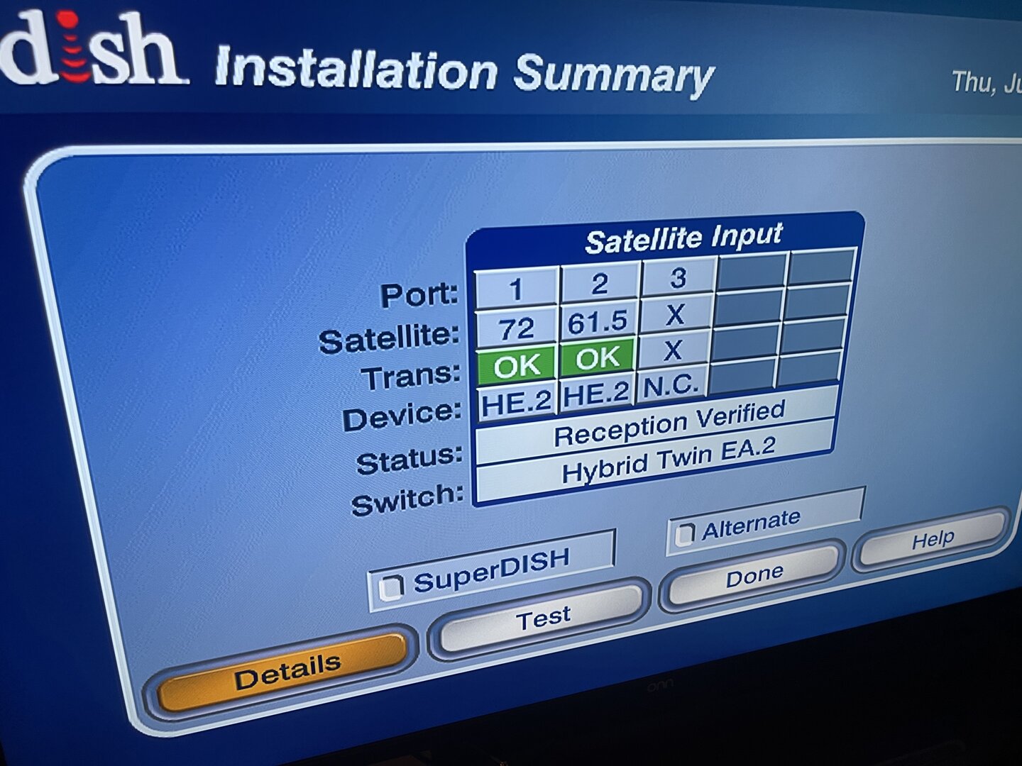

I'm pretty sure non-hybrid receivers don't disable port 2 on a hybrid LNB, should be fine if he truly has a Hopper1/2, since those do DPX and LNB>Duo Hub is how you can do 2xHopper's or Hopper/Superjoey before the H3. Only thing might be if port 2 is locked out to only do another Hopper/SJ, then there might be a problem. I have a H2000 and a 211z laying around so I'm probably going to test this to make sure, just need to setup a tripod in my yard
Reactions: TheKrell
Yep, this is the 211z running on port 2 just fine. Both this and the Hopper 1 play D101 no problem (they aren't active so that's all I bothered with), both pass check switch, and the Hopper shows all 3 tuners. For the giggles I also swapped the cables around and the Hopper worked fine on port 2 without complaints. So yeah, Hopper1/2 and any DPP receiver for that manner don't disable port 2, but I think Wally/Hopper Duo run in hybrid/stacking mode despite being retro compatible with DPP, and I'm guessing those would disable the second port/complain if not on port 1
