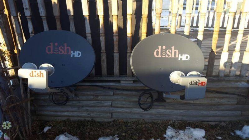

Hello I'm a newbie for this forum. I live in Sparks / Reno area have two 922's two 612's and 722k I'm receiving
110 / 119 / 129 I wanted to add a wing to get 61.5 to receive NYC locals in HD. What is the correct
EL / AZ / SKEW for that 61.5 location. The wing I'm using is a Dish 500 with DPP TWIN. My other dish is 1000.2 west cost arc. My first attempt using a birdog 2.5 meter. My check switch says 110/119/129 and no. 4 all show ok satellite verified. But no. 4 says
72.7 Not 61.5 So I guess I'm not on 61.5 for the wing. Thanks in advance.
You will not be able to receive New York locals in Hd or SD from your Reno location. NYs locals are on a spot beam that doesn't extend that far away.
Reactions: DWS44
I'm already receiving them (NYC) locals because of my RV is New York and when they changed my networks it also changed my receivers at home WCBS WNBC WABC AND WNYW fox I have an RV waiver
