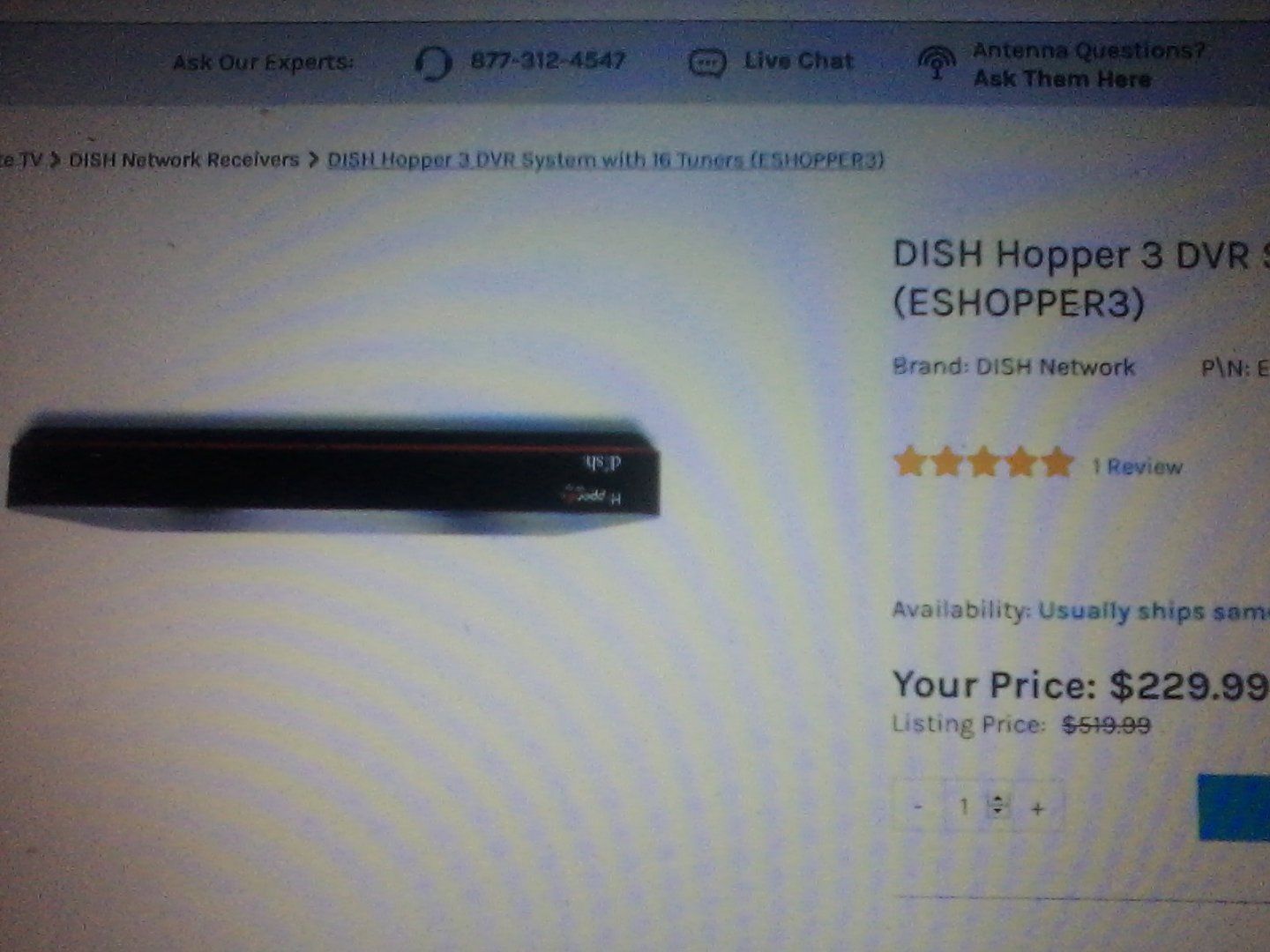

You would have to keep it for two years or more, before the savings in fees would offset the purchase cost, at least based on Solid Signal's pricing: DISH Hopper 3 DVR System with 16 Tuners (ESHOPPER3)
(Also in that link, their picture of the Hopper 3 is upside-down, which looks really funny.)
When I look at that Hopper 3 in the link the red stripe is on the bottom just like the one I have. The link looks fine to me.
This is in Firefox. Which browser did you use?
Reactions: TheKrell and HipKat
