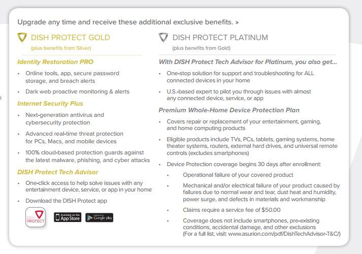

By the way, I looked at the Dish protection plans. I subscribe to the Dish Protect Silver plan for $8.99 per month. They offer a Gold Protection plan which includes a Tech advisor for $12.99 and a Platinum Dish Protect plan which includes a Platinum Tech advisor for $24.99. When I talked to technical support previously they offered me a technical advisor if I would upgrade my protection plan. At the time I declined. I am tempted to pay for the additional assistance if it would allow me to get the Dish engineers to fix some of the Hopper3 bugs.

Here's the overview on Gold and Platinum.

Here's the overview on Gold and Platinum. View attachment 129881
