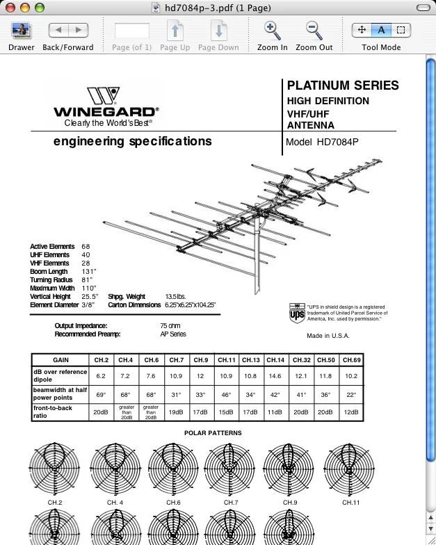

Here is a photo of my Voom OTA since the Stealth won't work for me.

I know they won't let me use that one
I know they won't let me use that one - it looks too big.

Its a shame as I am over 50 miles from the broadcasters and this antenna gets everything. Cant wait for scanning to see if I can pick up milwaukee as I live in chicago.
