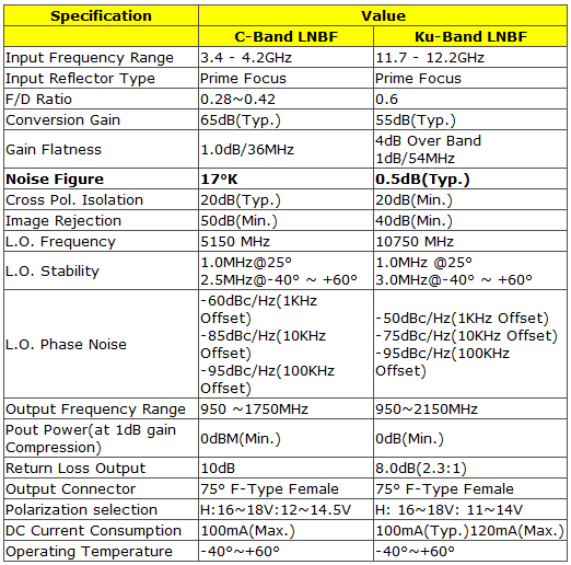

Regarding my equipment, I've got one of those 6ft solid Fortec Star dishes and an LNBF with the following specs:
I guess that I need a better LNBF, too.
Thanks for all the feedback!
Could be you don't have the LNBF in the "sweet spot". Maybe some tweaking in/out, along with making sure it's aimed at the center of the dish. Note: you may give up some C band performance when the feed is optimized for Ku performance.
What make and model of LNBF ? I had a WSI DMX741 that had the horizontal and vertical probes bent during manufacture. It worked ok on C-band but ku sucked. you get what you pay for. I now have a good Chaparral dual C-band feed and killer Norsat LNB's.
