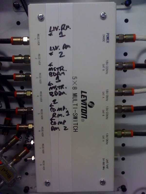

Picture attached 5x8 multiswitch
I have three DVR receivers. I have a triple LNB dish with four (4) RG6 cables running from the dish to a 5x8 multiswitch. From the multiswitch, I have (2) RG6 cables running to each of the three (3) DVRs. (see attached picture).
My question is, with the change to the 5 LNB dish, will it be necessary to run more RG6 cables from the dish? Will this multiswitch still work?
I understand that Directv provides and installs all that I need, but I want to know what to anticipate.

The 5LNB has 4 outputs. That's all you need and you say you already have that many ran. The dish itself doesn't NEED any wires (well, other than power I guess from the reciever). The wires are outputs for your tuners or switch. You say you already have the max of 4 outputs ran. So, no worries.
The dish MAST will be different with the 5LNB dish. The 5x8 multiswitch will be changed for a WB6x8. Your wire is already correct. Use this as an opportunity to inspect external fittings & cable to change out questionable stuff and make all neat.
Observe removal of the old mast for patching leaks. Same for installation of the new mast...assuming it goes in the same place.
Should be an EZ job.

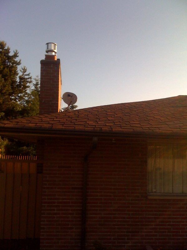

I attached a picture of my current setup. Didn't have a ladder handy, so it's not the best shot. But it does show the chimney.
The prevailing winds come from the Southwest, which is the chimney actually protects the dish from. It's also low enough, that the roofline protects it from the Northwest. I understand the problem of the dish becoming a 'sail', which is why I mounted my old dish in this location. I am completely confident that the wind won't knock it down.
I guess it depends on the installer that shows up, because the last installer had the attitude of, "hey, whatever you want to do". He was just excited that all of the 'grunt' work had been done by me. ;)
Anyway, the biggest thing that I want to avoid is drilling or screwing into the roof. THAT is NOT going to happen. I don't care who the guy works for, he doesn't own my house. If they want to keep me as a subscriber (which I have been since 2001), they'll mount the dish on the chimney. I just hope he comes with a roto hammer drill. ;)

I'm glad you told us that is a brick chimney it looks more like a composition board construction which I definitely wouldn't trust to support a Slimline. Be sure they don't use mortar joints for anchors, drill into the bricks only. You may be surprised at how much larger the Slimline looks than your Phase 3.

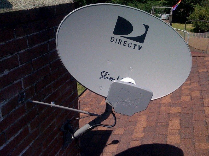

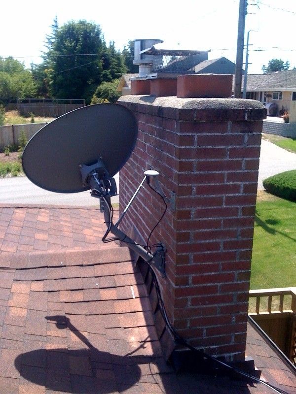

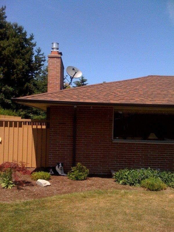

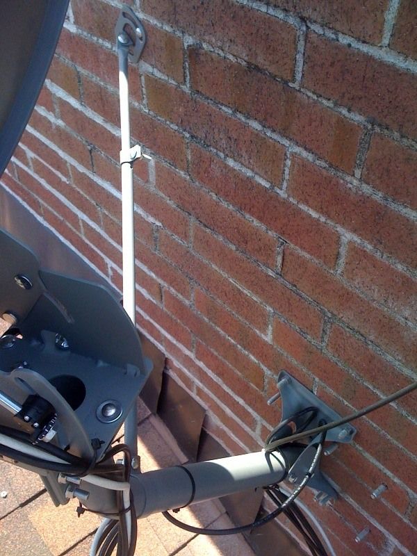

Just an FYI update, the DirecTV guy installed the new dish on my chimney this afternoon. I attached a few pictures. Actually, he didn't have a roto hammer or any brick anchors, so I had to drill the holes and actually mount the base to the dish, but that wasn't a big deal.
It also looks like a triple LNB, not a 5 LNB, but I get all of the HD channels. I guess the 5 LNB isn't necessary. Any thoughts?

The SWMLine SL3 receives the 99, 101, and 103 sats, which obviously is all you need in your area.
If you have any winds, I'd check the anchoring of the dish occasionally.
I'm near Seattle, so does that mean that I only need the 3 LNBs? Everything is working, so I'm not complaining. Do I not NEED all five of the LNBs? I'm clueless on this. I DO know that the DirecTV installer was very impressed with the signal strength I received, it was in the mid 90s.
Regarding the wind. I will certainly periodically check the anchoring for the dish. The really good thing is that the prevailing winds blow from the SW, which is on the opposite side of the chimney. In other words, the chimney will shield the dish from the wind. And the roofline is high enough on the other side to protect it from that direction.
buzzbar
If you don't subscribe to anything exotic (Internationals), you would be fine with a 3LNB Slimline. Your SD LIL come from 101W making this possible. If 110W or 119W somehow became a problem, you could swap for an 3LNB unit.
