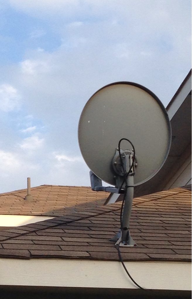

Would anyone venture to guess what the Dish 500 is (or was) pointing to? In the attached pictures, it is pointing approximately due south.
@boba--I purchased my home new and this dish was probably the first one that was installed when we moved in.
Thanks to everyone for their expert opinion! I will proceed removing the Dish 500 since this is likely the one not in use. I'll perform a quick test to make sure this dish is null;) Looks like I have some work ahead of me this weekend!
It's possible that's pulling the 129 sat.. Is there a switch installed anywhere? If there is, I bet that 500 dish is pointed at 129
I believe that the 1000 dish is getting the 110/119/129 and is getting the 118.7 feed from the plus dish. You're probably fine to remove the 500. :)
It definitely wouldn't be pointing so far south if it were pulling in 129. As boba stated, it was most likely at some point used for DirecTV reception @ 101.

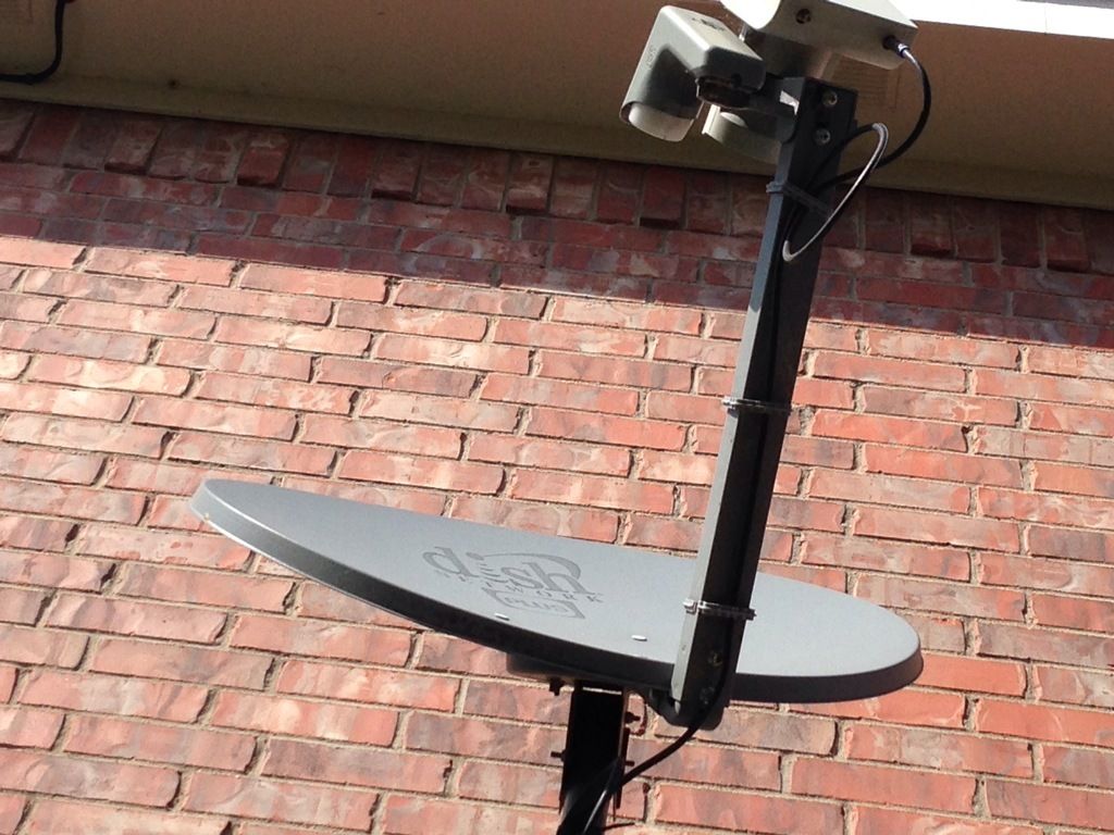

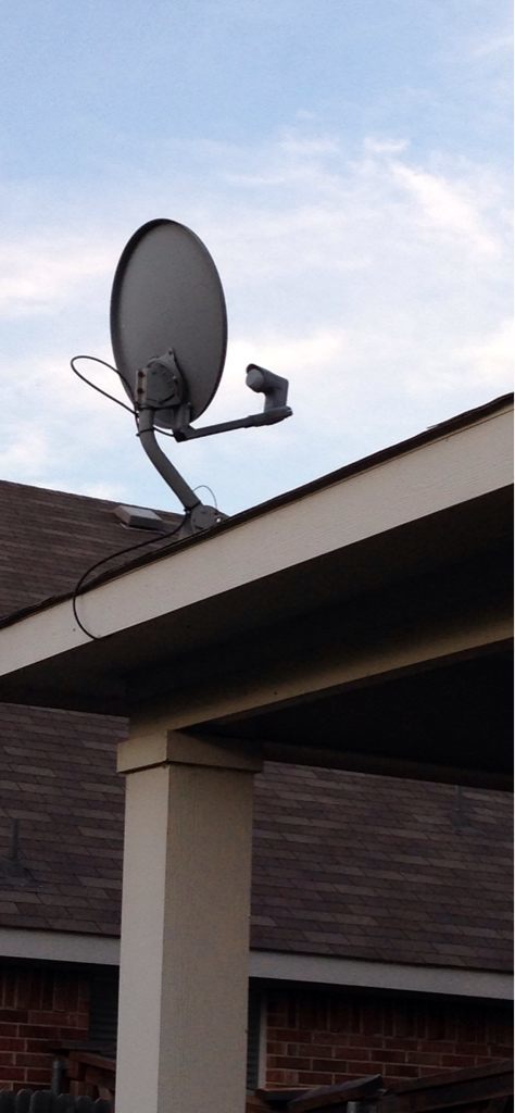

OP, your installation is a little odd, no doubt. It shouldn't be hard to fix, at least by a Dish technician, or even yourself if you have the safety/time/willpower/expertise to do it yourself.
It looks like the 129 LNB is missing from your Plus dish, effectively making it a 500 Plus dish. All that is needed to turn it into a 1000 Plus, would be adding another LNB (DP Dual) to the other side of the center (118.7/119) LNB. It could be that trees were blocking LOS to 129 for the Plus dish, hence the 1000.2 would be pulling in 129. Based on the picture, neither the 110 nor 119 LNBs are connected to anything. So that dish appears to be picking up only 118.7.
Obviously, the installer took shortcuts. The problem with the older Plus dishes, is that they did not have built-in switches, therefore they required a DPP44 to be installed inline (which requires a power outlet.) The installer got around this limitation for the old dish by connecting the 118.7 (FSS) LNB to the built-in switch of the 1000.2. So he took three different shortcuts (and I wouldn't be surprised if he took more shortcuts elsewhere.) Not only did he not have to bother with installing a switch, but he also didn't need to move any dishes. On top of such, if the 129 LNB on the Plus dish was having issues with LOS due to blockage/interference, then the 118.7 LNB probably doesn't need to be there either. Was this a recent installation or upgrade or is this an old installation/upgrade?
At any rate, there is a new 500+/1000+ LNB that has a built-in switch. It saves the installers from the trouble of having to install external switches versus the older design. Based on the appearance of the dish and your Device results under System Info, you are utilizing the 1000.2's built-in switch/LNB assembly (110/119/129,) with the 118.7 orbital slot being pulled in by the Plus dish.
Depending on when everything was installed, the installer could have just moved the Plus dish and swapped the old LNBs on the Plus for the new, simpler LNB plus the DP Dual for 129. Even if this was done before the new LNB was released, he still should have moved the Plus dish and used a switch.
