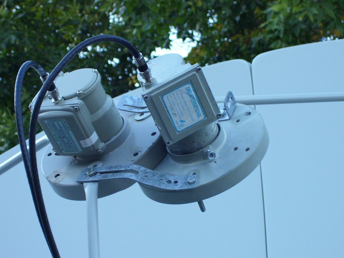

here is how I had mine near true south (my true south is 93...this was for 99)
LNB on left...basically the coax at the bottom and the bottom edge "flat" for true south
As for F/D, that's something I played with until I maxed out the quality. On my 6 footer, the B1SAT feedhorn throat is about 1/3" from being flush with the scalar. I did not notice a great difference in quality as I moved the LNBF closer and farther from the dish.
