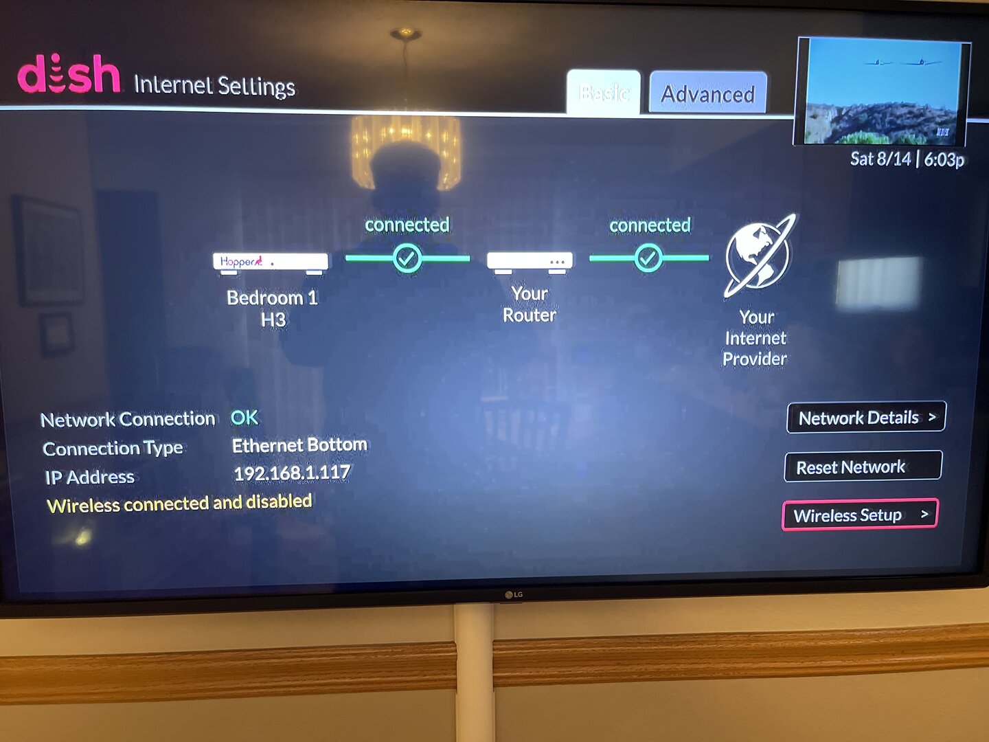

Here’s what you should see on the internet setup screen. Notice lower right corner.
You're going to have to put a WiFi Adapter in or get a replacement Hopper 3. Seems the onboard WAN isn't working on yours
