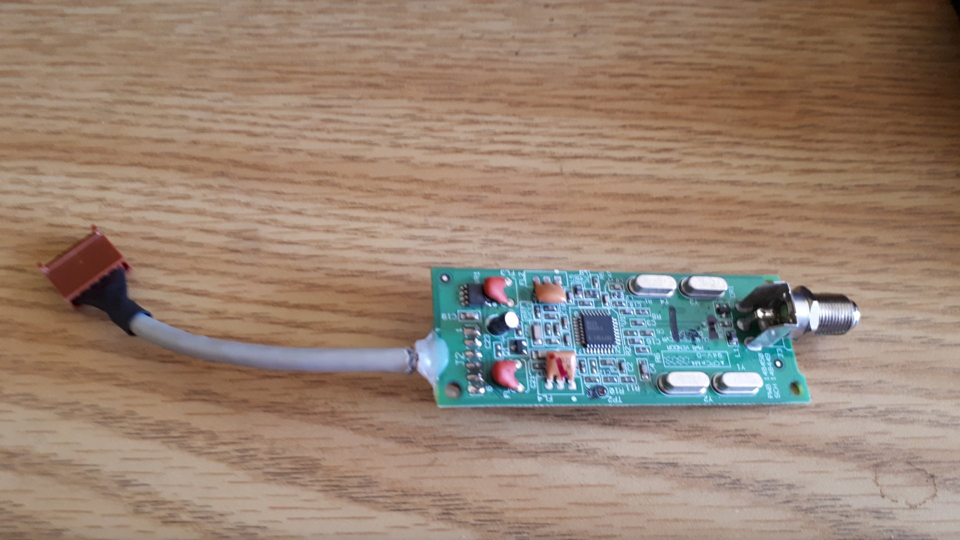

Hi,
Actually not a VIP622 but a Bell 9242 which are the same receiver. I've posted my problem in the Bell 9242 forum in Canada but no solution so far. So, I'm asking my US friends for a solution. Here's the problem. We had a power outage that lasted a few minutes last week. Now, I can't access the TV2 with the remote ( have three of them on TV2 and they were all working prior the power outage). I do have a picture on TV2. If I go to system info., no problem changing the remote address on TV1 but if I use TV2 remote to change the address for TV2, remote has effect (did tried all three remote). I do hold sat button until all mode flashes then input a address, press #, sat button flashes three time to acknowledge the change then press record however the new address doesn't appear on TV2 sys. info. Power reset and factory default (many times) didn't solved the issue.
If I put the receiver in mode one, TV2 does show the channel form TV1 and if the return to mode 2, channel is still there on TV2 but again no control with the remote.
So, am I missing something or somehow a lock receiver on TV2. Did phoned Bell CS but well you know....
Thanks.
It sounds like the UHF receiver for the TV2 remote went bad.

If you have a donor receiver, I believe the UHF receiver on these is still a separate board that just bolts to the case by the f connector for the remote antenna and plugs into the main board with a ribbon cable. It's been a while since I was inside a ViP.
Is the uhf antenna on the receiver itself? Or is it on a splitter behind one or multiple tvs? If it's on a splitter you can try replacing the splitter. Other than that I'd agree with the others that the uhf board is gone.
You are right, took a look this morning, the board can easily be swapped, sing le bolt on the RF connector and a 4 or 5 pin connector on the main board. Looking at a use rx. locally, will keep you posted next week. Thanks.
Got the donor receiver, definitely a donor, some caps. are ready to explode. Swapped the RF board and I am back in business, Thanks to all of you for the help.
