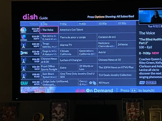

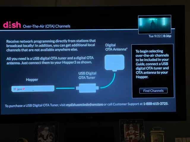

I have a similar problem in that my H3 doesn't think there is an OTA adapter connected, but I can still watch OTA channels, I just can't rescan. I have had this dual OTA adapter for several years and don't really rescan very often as long as I see the channels in the guide. I have unplugged the adapter for a few minutes before plugging back in but did not reboot the Hopper while unplugged. I guess I will try that next. All this talk about OTA issues is what made me check on mine.

Just tried, unplugging the OTA adapter, unplugging the H3, wait until it reboots and plugging it back in, but no joy. It seems Dish engineers have once again screwed up the software. I have been an embedded software developer/manager/director for over 40 years and clearly, Dish has a non-existent or poor software QA process. Considering the others who all of the sudden have OTA issues, I seriously doubt all of our adapters are failing at the same time. Mine is obviously working since I can still watch OTA channels; I just can't scan for any changes because the Hopper doesn't think it's present.

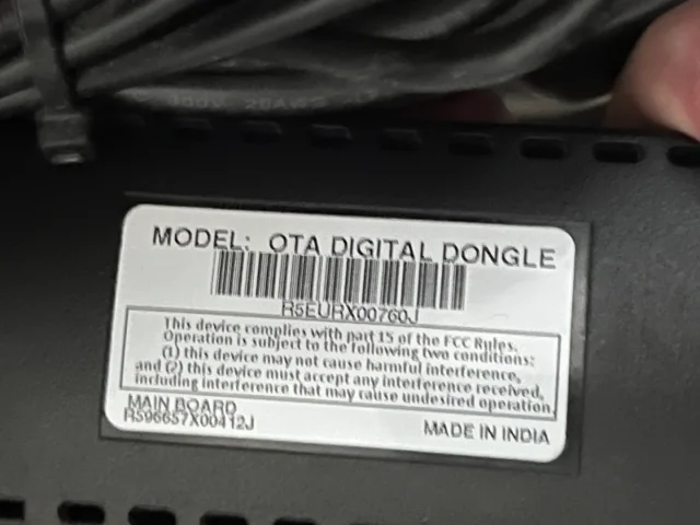

I can still watch OTA channels, but cannot scan because my Hopper 3 doesn't think there is and adapter attached.

from the picture, Model: OTA Digital Dongle is the single tuner OTA adapter which is the same one people are having problems with as I just checked what my single OTA adapter says which is left unplugged next to the Dual tuner OTA adapter which says "Model: Dual OTA Adapter" or specifically "Model: Dual OTA Adapter P/N 213293"
Thanks, not sure why I thought I had the dual tuner version. I guess I should look for that one.
New dual from Amazon installed and working on Hopper3. Guide automatically updated several minutes after scanning.
