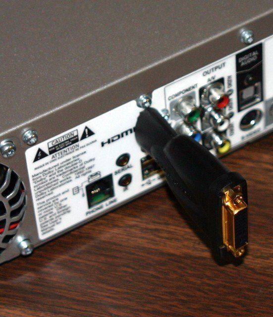

I do have an issue with most HDMI > DVI adapters. All the weight of the adapter and DVI cable are on the small HDMI connector. See the attached image. A member HDTVoice did find a solution though, see link:
http://www.bettercables.com/nfor20cocadv.html
The short adapter cable takes all the strain off the HDMI connector.
