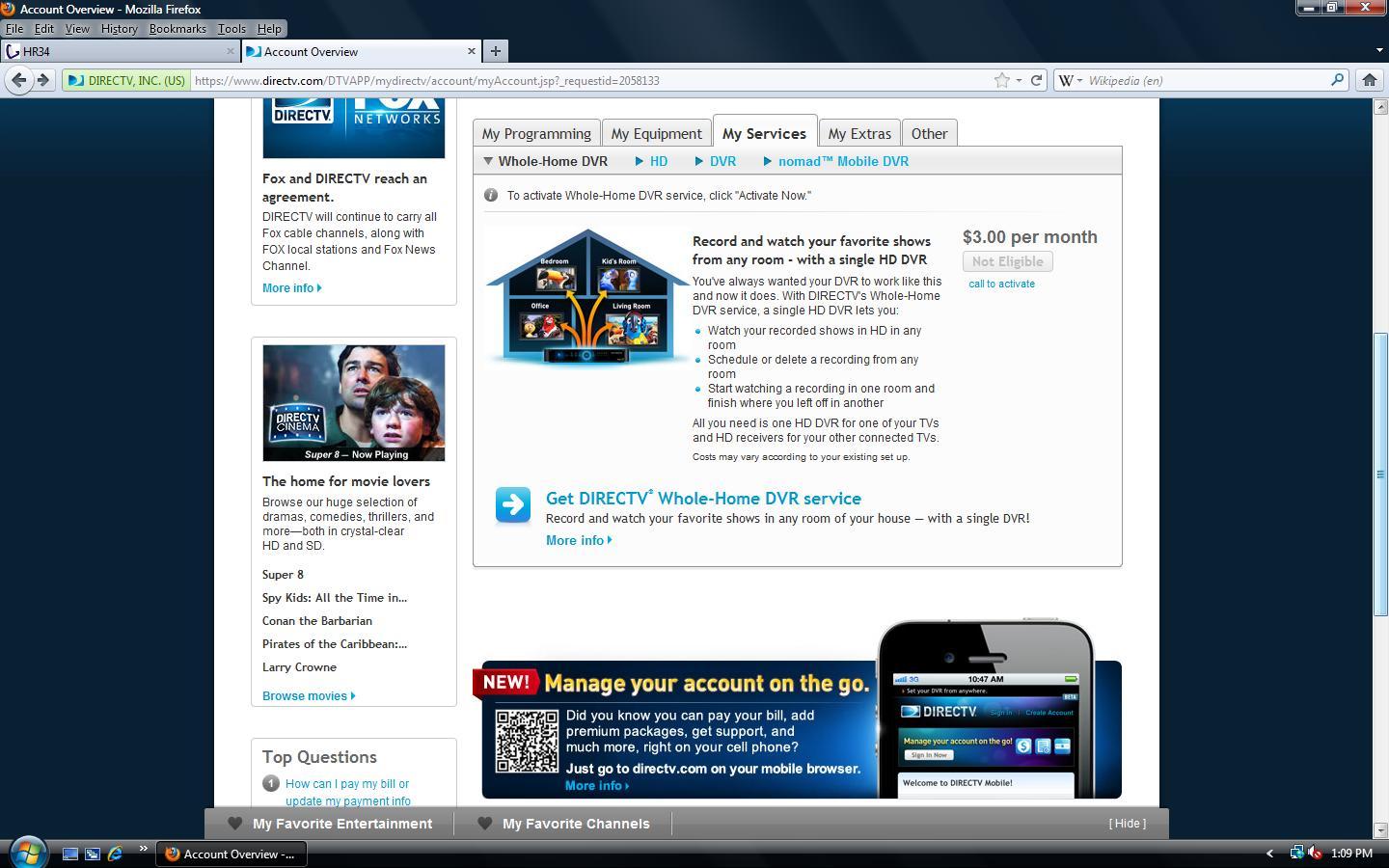

Directv told me I cant add MRV since the only 2 DVR's I have are R22's
2 R22's and a H23 on the account
myaccount shows "not eligible"
That's crap, put receiver deca's on all 3 receivers and flip the switch. It's not that hard, sounds like Directv is trying to force an HDDVR upgrade on you if you want it that bad. I would recommend swapping out the H23 and keeping the 22's because of them upgrading themselves to HR's but I know you knew that already lol
