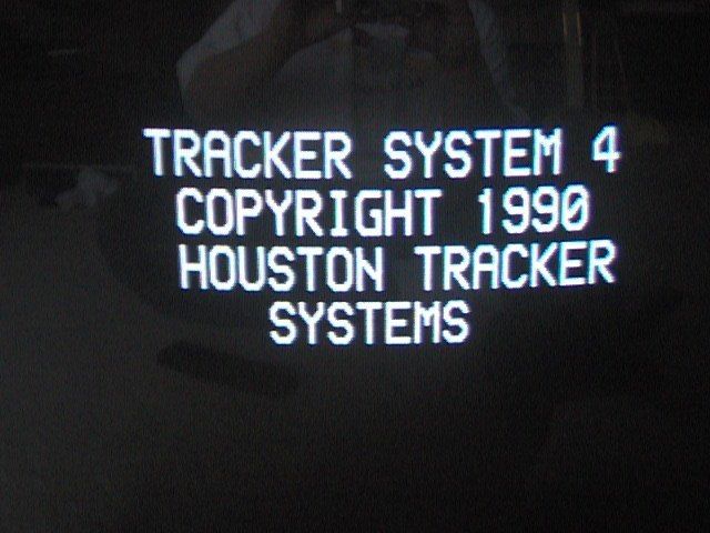

unit says "1990" when you turn it on so we're past the 10 years :) Havent opened up the VCII slot yet to see how old the module is.

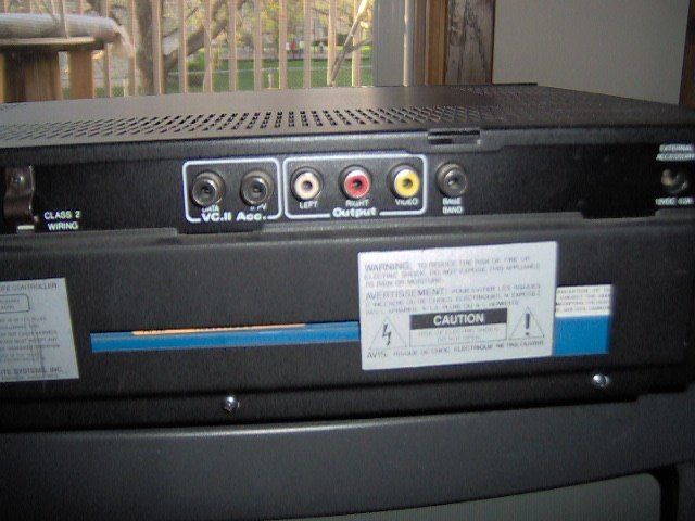

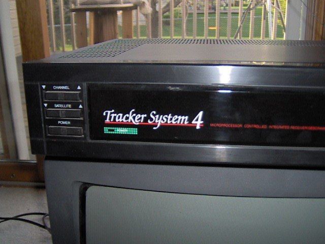

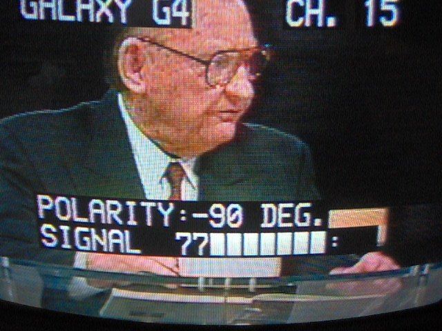

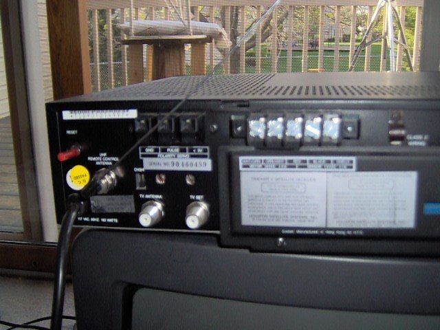

Here are some photos :)
3 of the unit
when you turn the unit on (yes that says 1990) :)

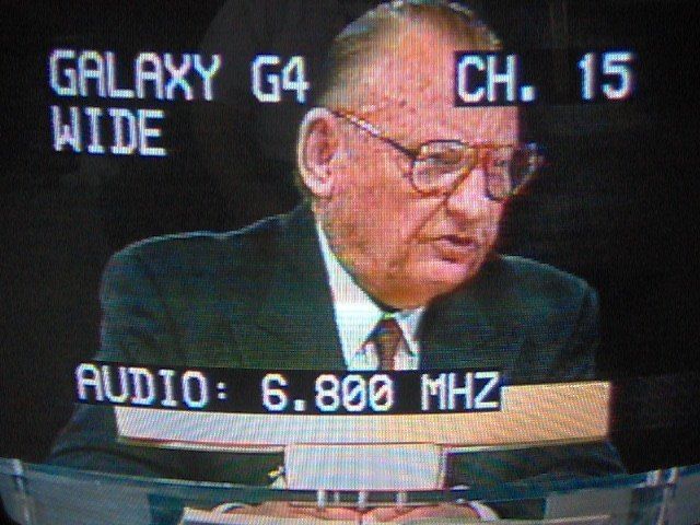

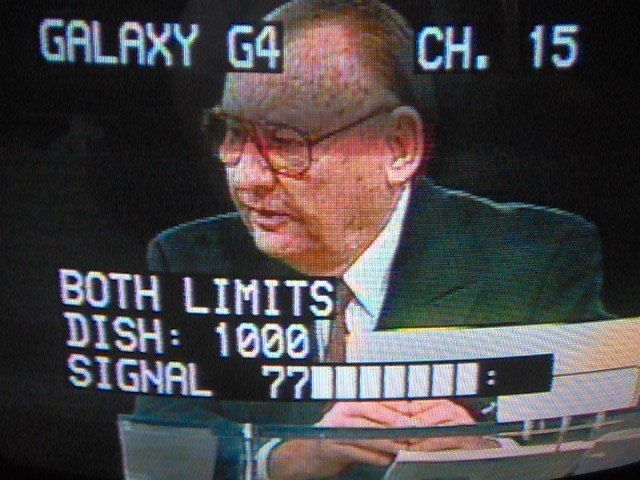

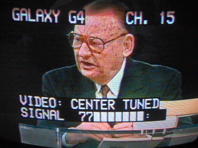

the screen when you cycle through the fine tune button
(the reason it says both limits is I only stored G4 and polarity is irrelvant as the DVB box controls it)

That looks like my HTS 70 menus that I see. I have my HTS 70 manual if you want me to look up something that might match your receiver. My receiver reads Houston Tracker 70 Copyright 1992 - 2006. Excellence in Design. Leader in Home Satellite TV. It updates every year in the copyright area. My receiver was $700 brand new back in '92. Bought it at some store in Westminster on Beach Blvd. My original remote busted in '96, but I got a replacement last December on EBay for $20 from a guy in Memphis.

Is that Lester Summerall in the picture there?
I have no idea :)
I just hooked up the cable, punched up channel 15 and away we went with pictures
No vertical channels
