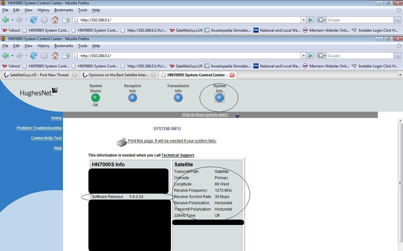

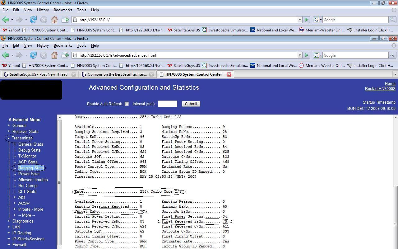

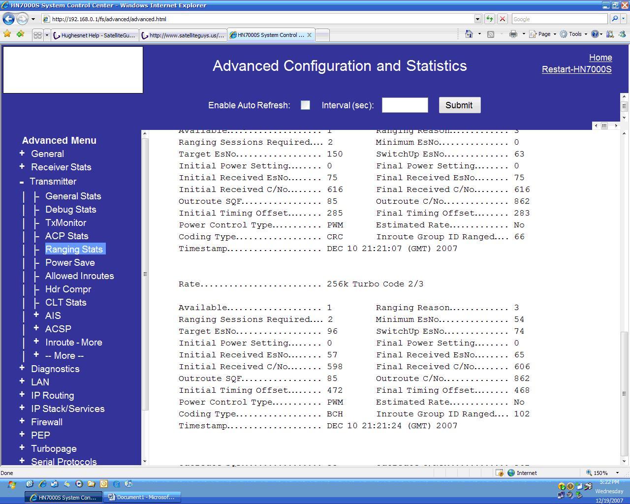

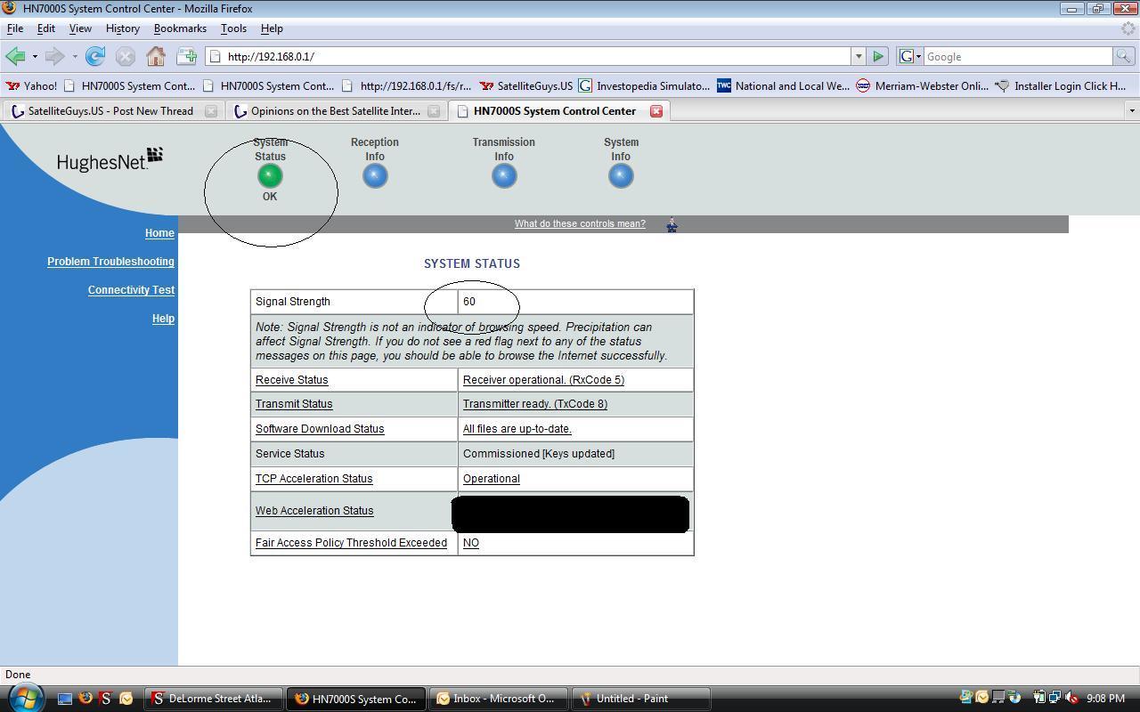

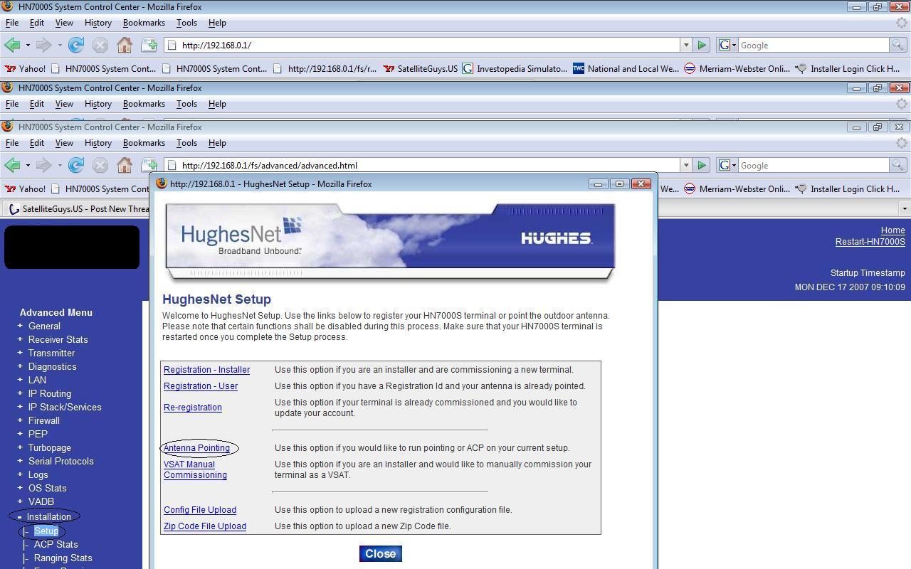

OK themorg I have some pictures below of what I want you to check out on your modem. I have circled the links to hit and what information I need from those links. Here are the addresses to get to theses places.
192.168.0.1
192.168.0.1/fs/advanced/advanced.html

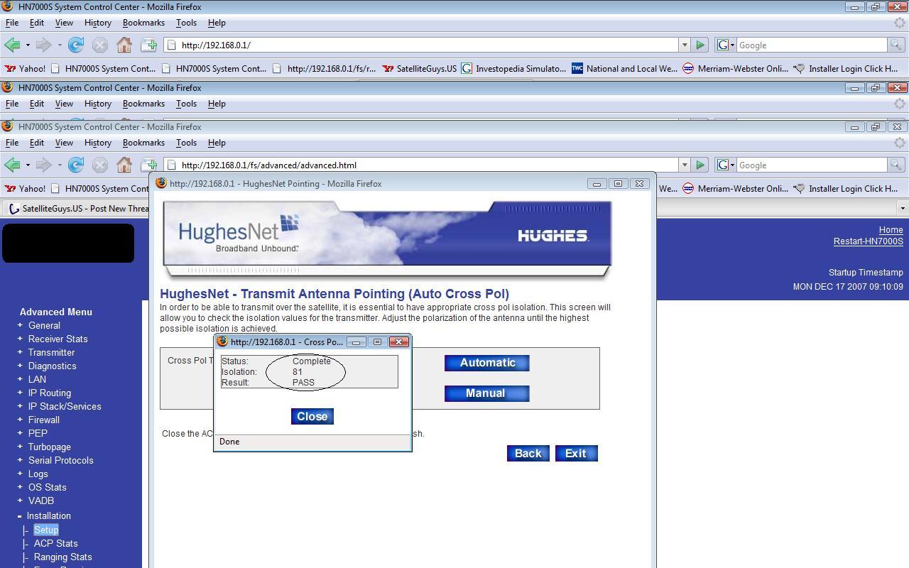

On the ACP just hit next all the way through and you only have to select automatic.

Tate, should warn them : If you cannot pass ACP, they system will not come up at all. May need to be prepared to tune the dish.
2 questions.
Can I make the assumption that if my system is currently working, that it should pass ACP in some way?
If I don't pass ACP, will my system stop working?

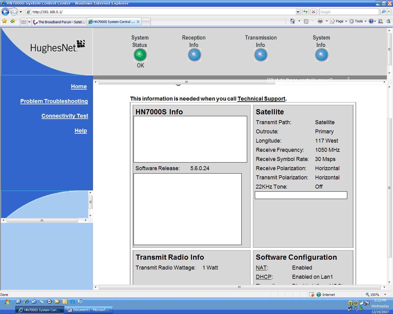

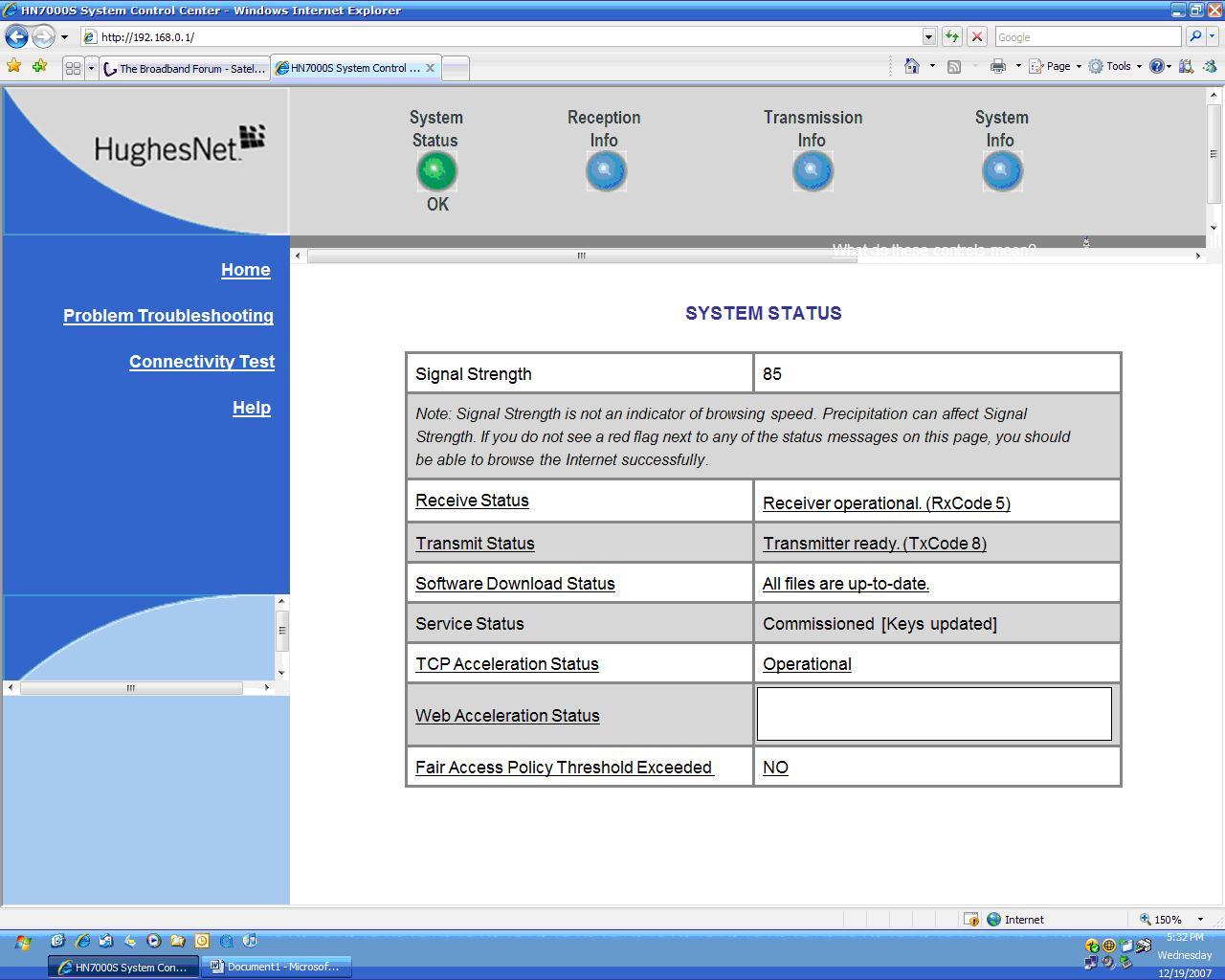

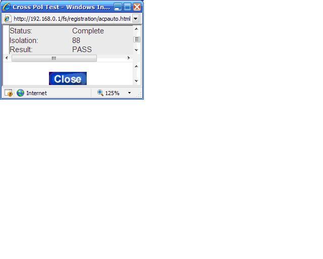

OK. Here are the pics of my results. Oh, a speed test too.

I'm really wondering, can it be a simple case that the freq I'm xmitting/rcving on has too many customers on it? Is that how it works?

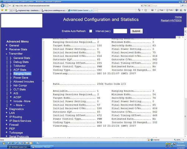

Wondering if you have a real high number of tx failures. Click on the tx "button" for that info.
I am glad you passed Xpol, because if you didn't the system will not come back up until you do.
Sorry I have not gotten back on this in the last couple of days. I have been away.
I am fairly confidant most of your problem is coming from the transponder you are on. That one I know is probably over populated. Your signal strength looks ok. Your crosspol should actrually be higher for that transponder. It should hit 95 to 99 constant unless you are up north. Also your EsNo is not the best. The target in your area is 96, it is recommended for maximum performance the final received EsNo should be within 10 points of that. In your case its 65. The EsNo is the amount of power the NOC sees from the transmitter. One problem I think Hughes has made is switching to the 45 watt power supply recently, but none the less that EsNo needs to come up. You might be able to do this with getting the ACP up also. If you are comfortable trying to do this yourself let me know and I will give you some pointers.
Another thing with your transponder "I may be wrong" I do not believe it uses DVB-S2-ACM. This is a new type of modulation that Hughes utilizes for a number of things one being better throughput during peak usage hours. Only the HN brand modems are enabled for this function. So even though you have a HN brand modem it is only working as a DW brand modem. There are a number of transponders on SM5 that uses DVB-S2 so if it does not I would request a change. You can check this by going to the same place you ran the ACP but select the Config Params 2nd one from the bottom. This screen will display all of your modems configuration. About half way in the middle of the page you will see DVB modem. Let me know what that says.

I have called them, and they are telling me that since I have a signal strength of 85, that they will not switch transponders for me without at least 3 days of speed tests. I did this back in December for them, called back, and was told they couldn't help. Now I call and they are telling me the same thing again. :mad: I am going in circles.
