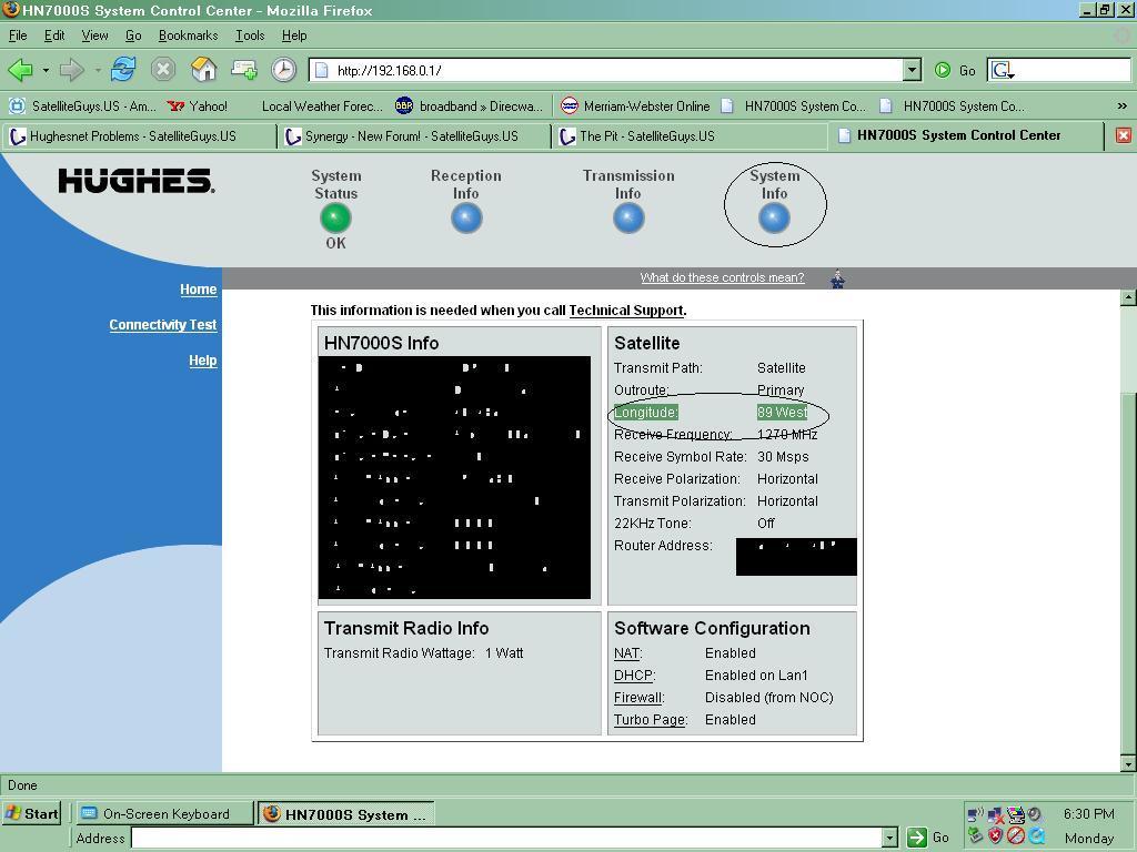

How do you determine the Sat?
The transponder will be shown as Frequency on the modem's System Info page.
The reported problems have included complete signal loss, then degraded connection when the signal returns. I'm not a Hughes-direct customer, but I'm told that, at the height of the problem, there was a recording on their tech-support lines saying that they were having SM5 problems.
It will be listed as 89W or 127W etc... on the system info page. To get to system info type 192.168.0.1 in the address bar and enter, you will see your modem and 4 "buttons , the last being system info, click on it.
See example below

[Thanks for the info. I am on sat 93W and TP 1086 Good speed during the day but slows at night. QUOTE=dirkleearm;873296]It will be listed as 89W or 127W etc... on the system info page. To get to system info type 192.168.0.1 in the address bar and enter, you will see your modem and 4 "buttons , the last being system info, click on it.[/QUOTE]
[/QUOTE]
Your system is pretty new isn't it.
Thanks for the info. So I guess I'am on Sat. 93W TP 1086.
