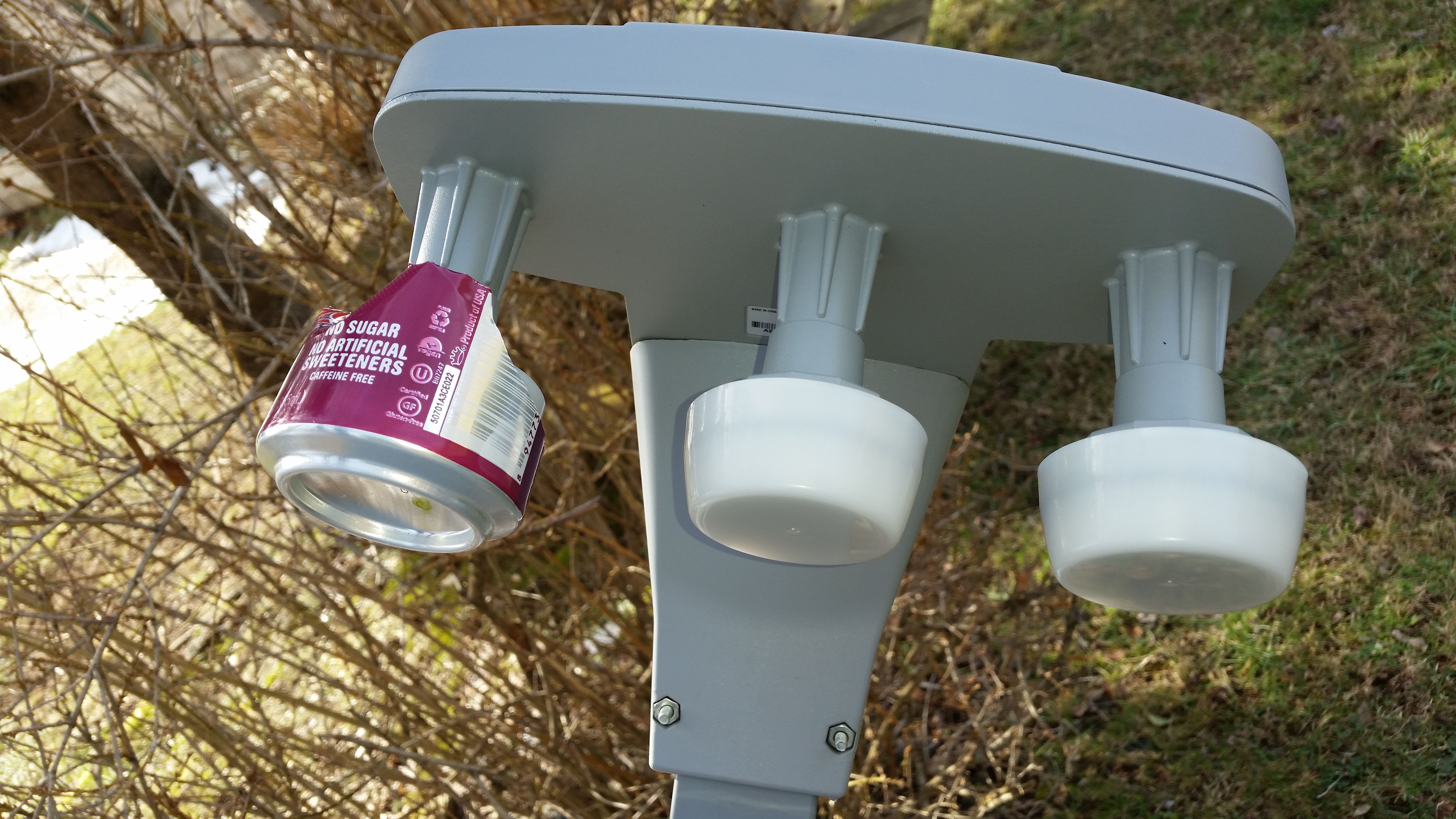

how would he figure out which one to cover?
This pop can killed 129 on a regular 1000.2 lnb. Going to assume the new dph lnbs are laid out the same way.
That's cool. So it's simple as that???[emoji51]. He said he would see if he could get al three with the 1K.2. If not, I will insist to cover the 129 up on the hybrid, and keep wing dish. Thanks for the help gang!!!! This is why I love this place!!!!!![emoji2][emoji2][emoji2][emoji106]
