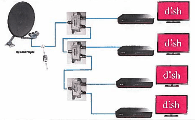

The top picture is rough but this is off the Tech site we use. That component after the dish is a Power Inserter, I believe

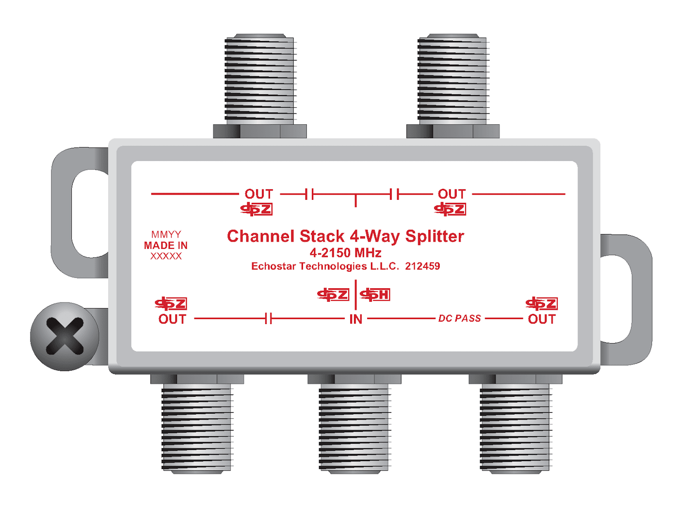

I like the bottom photo with a 4 way splitter a whole lot more than the top! What is the deal with those daisy chained splitters?
Yeah, if all I had were 2-way splitters, I would stack them and not daisy-chain them. Those last two receivers will be seeing 7 dB less signal than the first and 3.5 dB less than the second receivers.

I may have answered my own question. This schematic i found on dishformyrv.com shows the power inserter between the main wally and the splitter.
Now my last question is, do i need a terminator on the open port that i wont be using on the splitter? I've seen 75ohm terminators (i believe thats what they're called) used to "cap" open ports on videos of other sattelite installations with switches.
