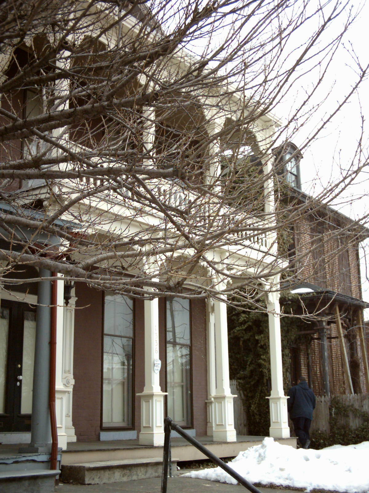

Here’s a picture of the balcony. Note, I do wish to have the dish as “out of view” as possible. The roof would be perfect but, I really don’t want to be up and down on the roof that much.

edit-the house is brick. Balcony is wood. When I talked about the balusters maybe being in the way...the lnb points directly into the wood but I think the dish is clear. the tree you see doesn’t seem to interfere it looks taller in the picture than in real life.
