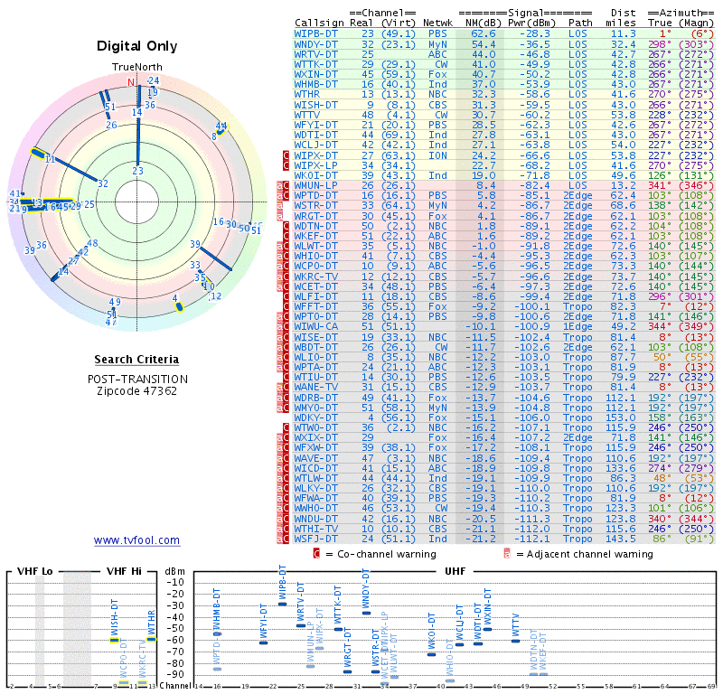

My zipcode is 47362. Large trees are on the west side of my house and there is no clear view of the south/south west.
I did the antenna web thing. It said a need a medium directional antenna. I am about 50 miles away from Indianapolis.
There are stations that are Northwest, west, southwest that I would like to receive. Ch 4,6,8,13, 20, 23, 29,40,49,59,63 Ch 4 will be decreasing power but increasing ch 29 power after the change over. Ch4 and Ch29 are the same station. Ch13 digital channel will be moving back to Vhf after the change. Ch 8 will remain in the VHF band after the change.

Wow! you actually have signals that you want coming in from FOUR different directions. Most of the channels will be coming in from due west or ~271 degrees. Channel 49 WIPB PBS is coming in from due North or ~6 degrees. Channel 23 WNDY MyN is coming in from west north west or ~303 degrees. And Channel 4 WTTV CW and Channel 63 WIPX ION from the southwest or ~232 degrees.
OK this is going to take a little experimenting on your part. First off I would buy something a little larger than the recommended antenna to make up for trees and your other obstructions. I tend to favor the Winegard HD 769 series. These are new antennas that cover channels 7-69 very nicely. I'm thinking maybe a HD 7695P (Red Zone) or a HD 7696 (Blue zone). Install facing due west. You might get lucky and pick up 23, 4 and 63 off to the sides. You may want to turn the antenna a little to the southwest if 4 and 63 give you trouble. Channel 23 is one of the stronger signals in your area. Your biggest problem, as I see it is with 49 due north of you. But maybe not. That station is only 11 miles away and the signal is very strong. You may have to install a small inexpensive UHF only antenna like a Winegard PR-9012 or similar to receive PBS. You can combine the two antenna signals together and run them down a single coax to your TV.
I hope this helps. You have a challenging but very doable application. Let us know if we can help any further.

As far as channel 49. If tvfool is correct 49.1 will be more Northwest after that change.

If I were you I'd put up a channel 7-69 antenna and aim it at about 267 degrees. That would get 8 stations reliably without a rotor or combining. If you misaimed it slightly to the north you'd add WNDY and perhaps WLFI, slightly to the south would pull in WTTV, WCLJ, and WIPX.
Once that is working then start playing with reception from other areas. That could be a second antenna with a rotor and A/B switch, or several fixed antennas with Jointennas.

That has changed a little. I studied tv fool website direction.
It is now three directions. The two station I think, I will have trouble getting in.
Whmb 40.1 (16) and Wipx 63.1 (27)
I think wipb tv 49.1 (23) will come in very strong so keep the antenna to west will not be a problem.
If look at tv fool website, and had a super antenna (Dxing) I could receive signal from all directions.
I just noticed a conflict. I may have to contact both stations about this.
After the change according to tv fool website
Wipb tv real channel is 23, Wipb tv virtual channel is 49.1

You only need to be concerned with the "real" channel numbers. The virtual channel number is just the number displayed by the digital tuner. You're good to go; no conflicts.
As far as using 91XG & YA-1713, you should be able to pick up eveything down to WLFI-DT(CBS); unless your TV FOOL profile differs from what your zip code indicates. Put both antennas on a 5 foot Radio Shack mast above the rotor. About 25-30 feet off the ground with no more than 100 feet of RG-6 cable; and you should be good to go.
If you can post your exact address TV FOOL profile; a better overall assessment will be possible.
** I agree with the comments about the Winegard 1080. My neighbor put one up(40 feet AGL) and it barely picks up VHF-8 @ only 6 miles out. It's not very impressive on UHF either. A decent pair of rabbit ears would easily outdo it.
