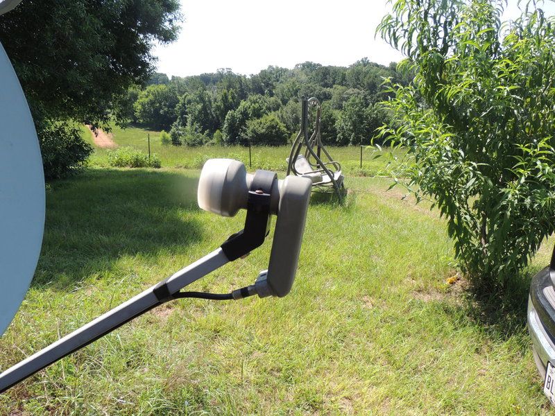

What I want, is to use this thing for FTA I thought the codes were part of it since I am not getting anything. If I don't need codes, all the better. I'm seventy years old and would like something to tinker with without having to go searching for latest codes.
What is lnbf,linear FSS not circular DSS
If the LNBF fits to a 'D' tube, the one you found, if it fits into a clamp, the LNBF jmc98 found.
Your LNBF is held by a clamp on it's 'throat' so I'd go with the Titanium PLL. It's a much better performing unit.
