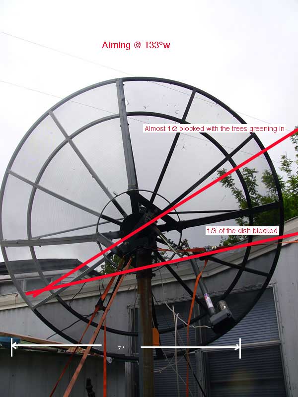

i have some trees in front are they a problem
I have up to 50% blockage on my west LOS and am able to pull signals. I only have a few problems with 8PSK signals.
Lately my 72º-74º LOS is greening in and is probably 60%+ blockage causing problems nailing the NBC mux.
Fall Is just around the corner. :up
Whether the trees are a problem or not will depend on the elevation angle and how far away they are. If you have have something like a transit you can plot obstructions (elevation angles) versus azimuth to see if you have anything blocking a satellite. Structures such as buildings and water towers should be a part of your site survey as well as trees.
It's hard to tell from your photo about the trees (since you took it not in the plane of the with the dish/feedhorn/satellite alignment, plus how far away the trees are).
dishpointer website is pretty good for finding out about distant obstacle clearances (i.e. if a neighbor's tree is in the way of a satellite from your dish site).
trees do make a difference - a neighbor's tree blocks some of my c-band dish from AMC-6 so several signals are not as strong in the summer as they are in the winter. I'm hoping the neighbor will trim the tree this winter like they usually do when the tree gets unwieldy and then I should have AMC-6 strong yearround until it grows out again.
the trees are like 25 30 feet away from the dish but ill get alot of stuff out there im using an actuator
